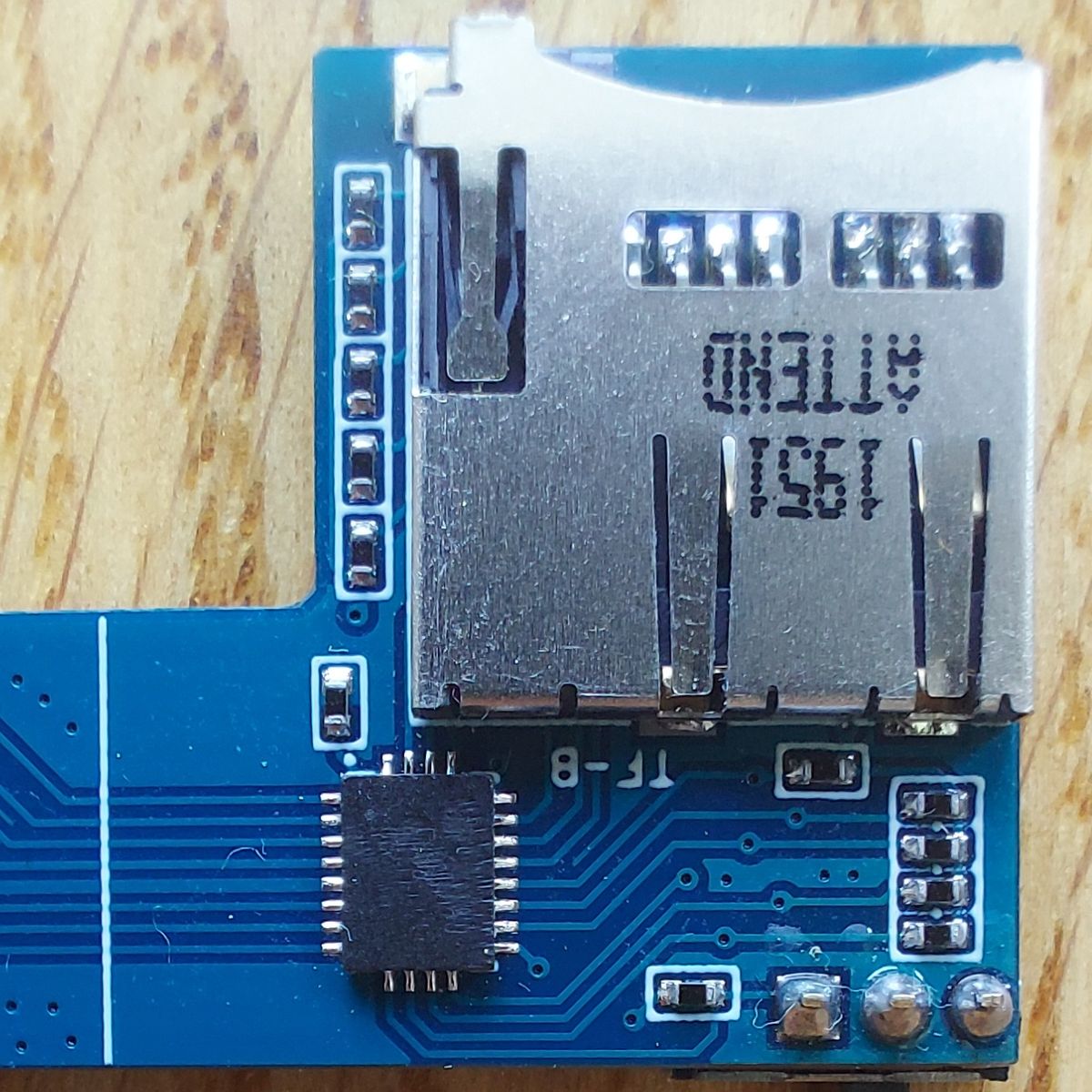

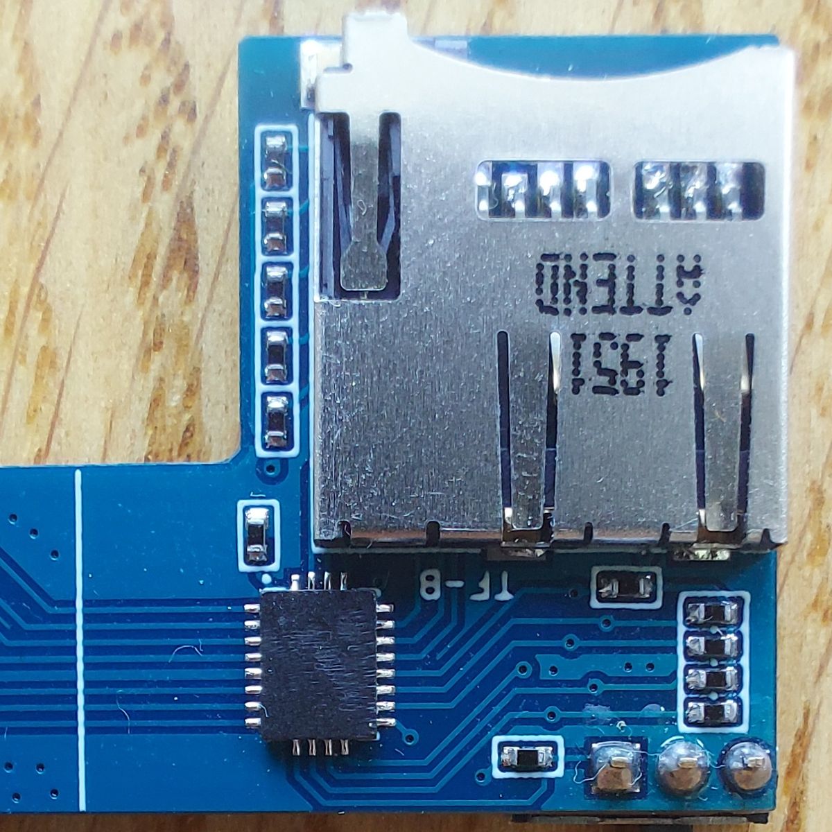

racko, this adapter has one chip on it - can you read what is it?
Unfortunately it's unmarked.

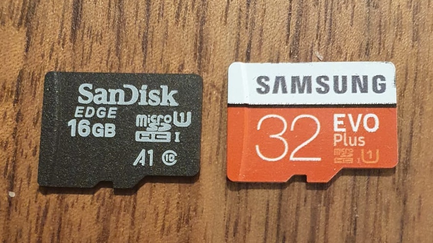

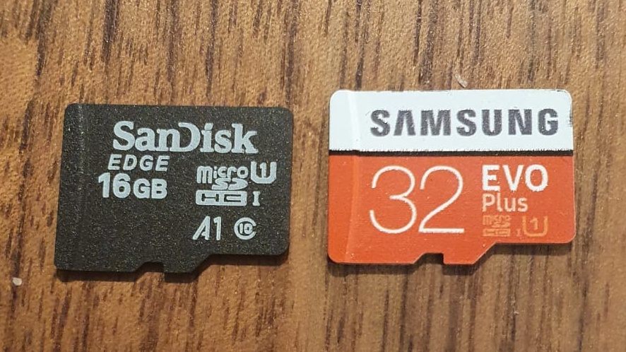

What is the difference between these two SD cards apart from their capacity?
SanDisk is working and Samsung doesn't work with the switcher with RPI4 8GB. Both of them are working when inserted directly in RPi.

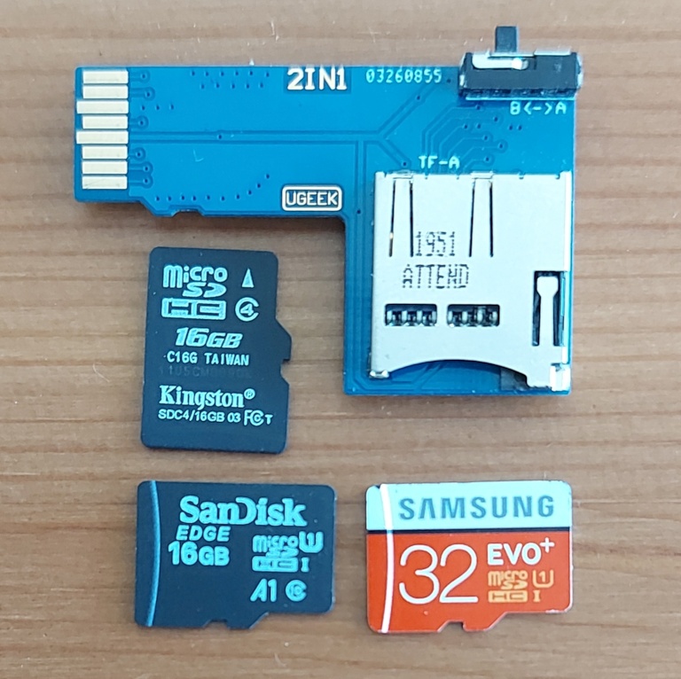

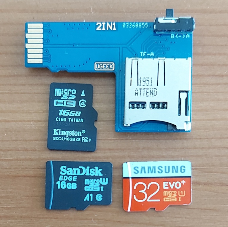

Hi!
I just bought this switcher and I have a problem. My RPi4 is booting LE from both SD cards inserted in the switcher but only when LE is installed on a SanDisk 16GB and a Kingston 16GB.
It doesn't boot from Samsung Evo+ 32GB. I even tried with only the Samsung card inserted in the switcher, in both positions, no boot.
It starts booting LibreELEC, the LE logo is appearing on the screen and right after I get an error message related to mounting problems or something like that (I can take a picture with the error messages if needed).
LE is booting from the same Samsung SD card if I insert the SD card directly in RPi (without using the switcher) so I know the SD card is good.
I don't have other SD cards to test so I could not figure it out what is the problem. Anyone knows why it's happening this?
Thank you!

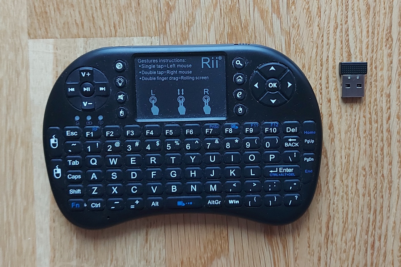

Well, the USB controller which RPi 4B has it's not the one of best ones regarding to compatibility with older USB devices - I have an old USB HUB, working everywhere except RPi 4B.
I cannot say that is a compatibility problem with the RPi USB controller, the wireless keyboard is working just fine. The problem is that when I'm connecting it, this is affecting another USB device connected to RPi4. In my case, the USB sound output over S/PDIF is messed up.
USB can be "fun", there are ton of odd devices out there, and especially audio (and video/webcam) devices can easily break if other devices consume too much bandwidth. Which is probably what the keyboard is doing (for whatever reason, probably because it has a somewhat broken USB configuration...).
I did a few more tests, including with LibreELEC 10.0 BETA2 and the same thing happens. I tried even with a basic wireless mouse instead of the keyboard, with same outcome.
To whom can I address this issue? I don't understand if this bug is related to RPi4 hardware/firmware, Kodi, LibreELEC or a combination of those.
In meantime I discovered another annoying issue: CEC stops working on RPi4 if another CEC enabled device is connected to the TV. This puts me in a very difficult situation as I don't have any posibility to control Kodi on LibreELEC. If I connect the keyboard the sound gets broken over USB and I cannot use the TV remote because CEC is not working (I have another CEC enabled device connected on my TV). The only way to control Kodi is using a remote control app from my smartphone. I cannot also choose what to boot from PINN because I cannot use a mouse or a keyboard. I used to use the TV remote control for this but now I can't use it anymore because of the CEC issue. Now, that's a funny situation ...😄
I have to admit that these issues are pretty frustrating, I wasn't expecting to this when I bought my RPi4. On my old RPi3 I don't have any of these problems, everything is working as is supposed to.

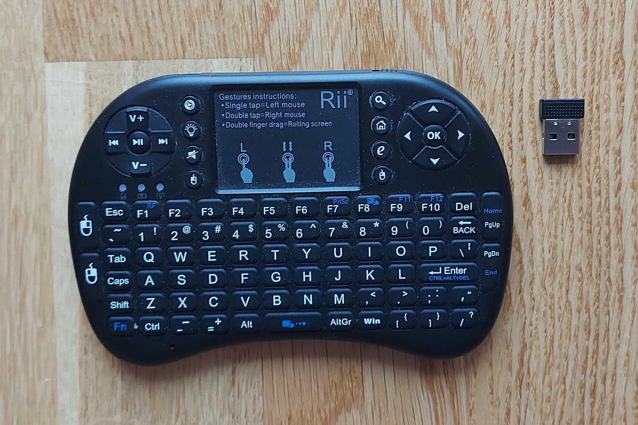

Hi Hias! Believe it or not, I found the problem. You can see it in the attached picture.
It's beyond my understanding, it didn't crossed my mind that this wireless keyboard could interfere with another USB device and cause such a problem. I used it in the last two years on my Rpi3 without any problems and when I bought the Rpi4 I've just hooked it in an USB port and left it there.
A few minutes ago I said to try one more time the RPi4 from the ground, without HifiBerry Digi+ Pro attached and I also removed the keyboard dongle. I flashed Volumio in first place and when I tried to play a 96/24 FLAC the big surprise came up. It plays everything as it should on Volumio.
I flashed LE 9.2.6, it's working perfect, no problems at all.
I did a few tests and I tried all four RPi's USB ports with different combinations. Everytime I was inserting the keyboard dongle in the RPi the USB audio output was messed up.
I don't know why this is happening and if this is normal but is good to know about this issue. Maybe it could be solved if it's related to the software.
Thanks a lot for your effort in helping me and I'm really sorry for the time you lost but, as I said, it didn't crossed my mind.
