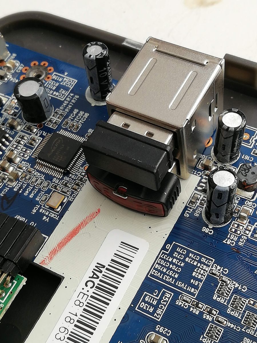

    Referring to the attached photo, does anyone know what these two USB dongles inside the Wetek are for? - I have tried plugging then in to my Linux machine to find out what they are and they both seem to be HID devices, one possibly a mouse receiver and one possibly a keyboard receiver. I don't think the Wetek Play 1 came with either a mouse or keyboard so I can't see why they are there. If however I remote the bottom on (the one with the red light) and then power on the Wetek, instead of booting to Android, it simply shows the first Wetek logo screen repeatedly.
