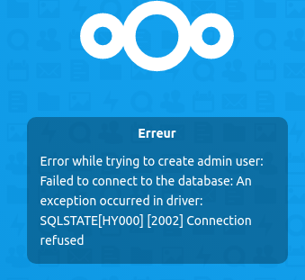

I installed NextCloud and MariaDB addons, but when I connect to NextCloud UI for the install process (when we specify DB address, user and password), I got
<br>
Quote
SQLSTATE[HY000] [2002] Connection refused

but when I try to connect MariaDB from Nextcloud, this just doesn't works:
I tried all combinations of:
- using MariaDB root login / pass, or dedicated
nc
DB user / pass (that have all privileges onnc
database) - using as DB host and port: all combinations of ("172.18.0.3", "mariadb") for host and ("3306", blank) for port
Later I noticed that in NextCloud log file for every attempt there was this error:
<br>
Quote"remoteAddr":"192.168.1.45","user":"--","app":"no app in context","method":"POST","url":"/index.php","message":"Host 192.168.1.115 was not connected to because it violates local access rules","version":"20.0.6.1"
