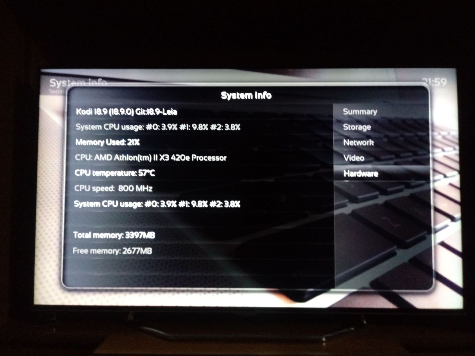

    Libreelec detects the CPU as 800mhz instead of 2.6Ghz ( Bios detected the CPU fine ) does this have anything to do with the skipping ?. The upgrade to the new CPU DID allow me to play higher bitrate videos.
  • Correction:
    Right after you switch to the menu the CPU is at the correct frequency but at some point it drops to 800mhz and starts skipping. So its some kind of power saving setting.
