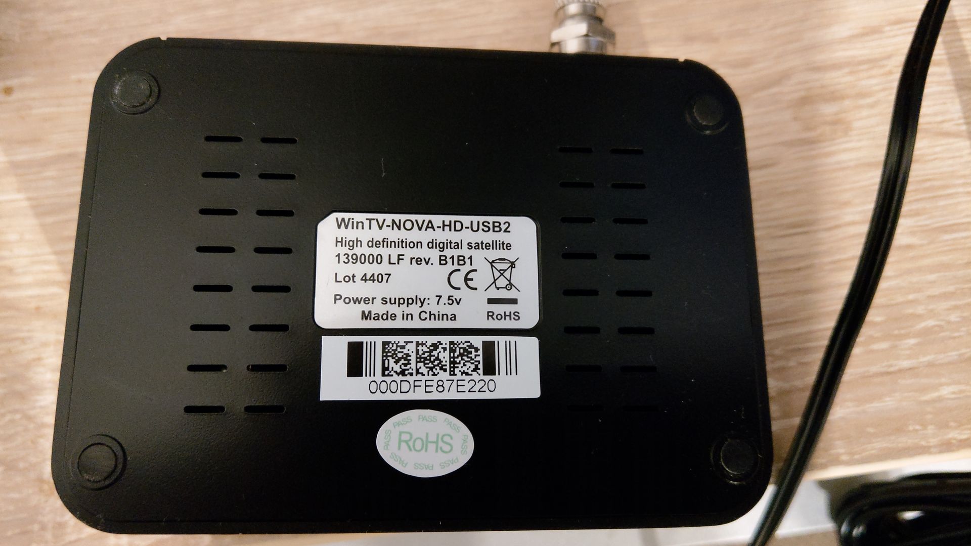

anyone some experience with this USB dvbs2 tuner?
Tested all driver options all the same tvheadend server don't show the tuner. Anyone any idea

can you unplug it, reboot
then after reboot wait a bit and plug it in again
then dmesg | paste
maybe we get an idea whats happening
On every driver package or is that unnecessary which one?
Ok so tested it for comparison reason with to devices, Pi3 (Libreelec 9.2.6 /standard drivers) and cubibox (Libreelec 8.2.5 /standard divers)
Turn both on, removed USB Tuner, reboot, wait half - 1min then log.
Only the pi3 turned black completely first try pluged back the USB. Second try all fine

patch required to support for 2040:d900 device
first thx and second can u someone tell me the command for apply the patch?
I know wget then adress but then? Because apt-get is disabled in libreelec
Ok recognized that I haven't done patching in this case. So it would be awesome if someone can tell me a how to or where I get a how to because I can't find one.

LibreELEC-RPi2.arm-9.2-Haupage-WinTv-Nova.img.gz
manual adjusted the patch, no idea if it works
so better make a backup
OK thx my friend for all the work. I will test it and let u know.

Edit: Tested it today and runs perfect without any problems. Thx for the help.
