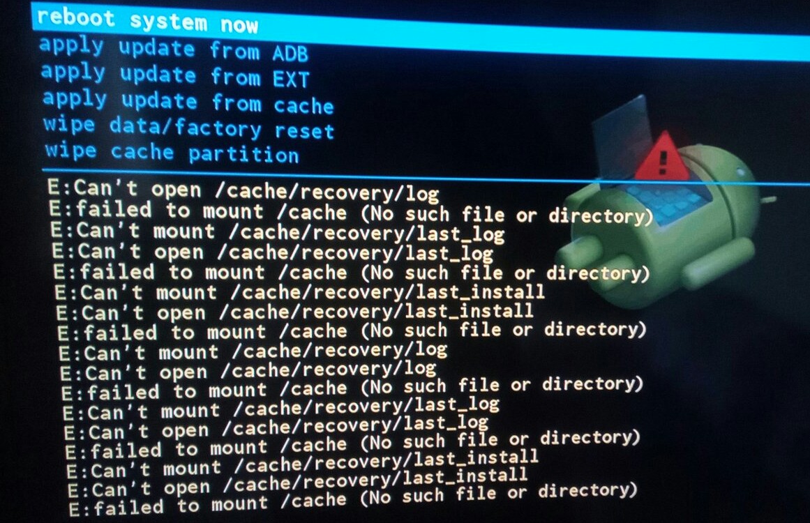

    With 7.0.3.3 burned onto my microSD card, the device will only either boot up normally or I can put it into recovery mode, but never will it boot from the microSD card.
    I've also tried putting the img itself on the microSD card and renaming it to "recovery.img" and adding a factory_update_param file. In recovery mode when I select the sd card, it doesn't show anything. But if I load the box normally then go to settings, system updater, local updates, I can go to the sd card and select the .img. It'll then try to update using it but it fails to prepare.
    I've also tried leaving the img in a zip but zips don't show up in the "apply update from EXT" area either.

    I tried the newer versions and it's the same thing. I hold the reset button with a toothpick and plug in the power and it doesn't boot up anything, only takes me to the Android System Recovery screen where you can reboot system, apply update, or factory reset the box.

  • I tried the newer versions and it's the same thing. I hold the reset button with a toothpick and plug in the power and it doesn't boot up anything, only takes me to the Android System Recovery screen where you can reboot system, apply update, or factory reset the box.
    The same thing with my MX Pro S805 box......just take me to the same Recovery mode.

    I've tried holding it less but it still only goes to the recovery screen. Even if I plug in the power and press the reset button once, it still goes to the Android recovery screen.
