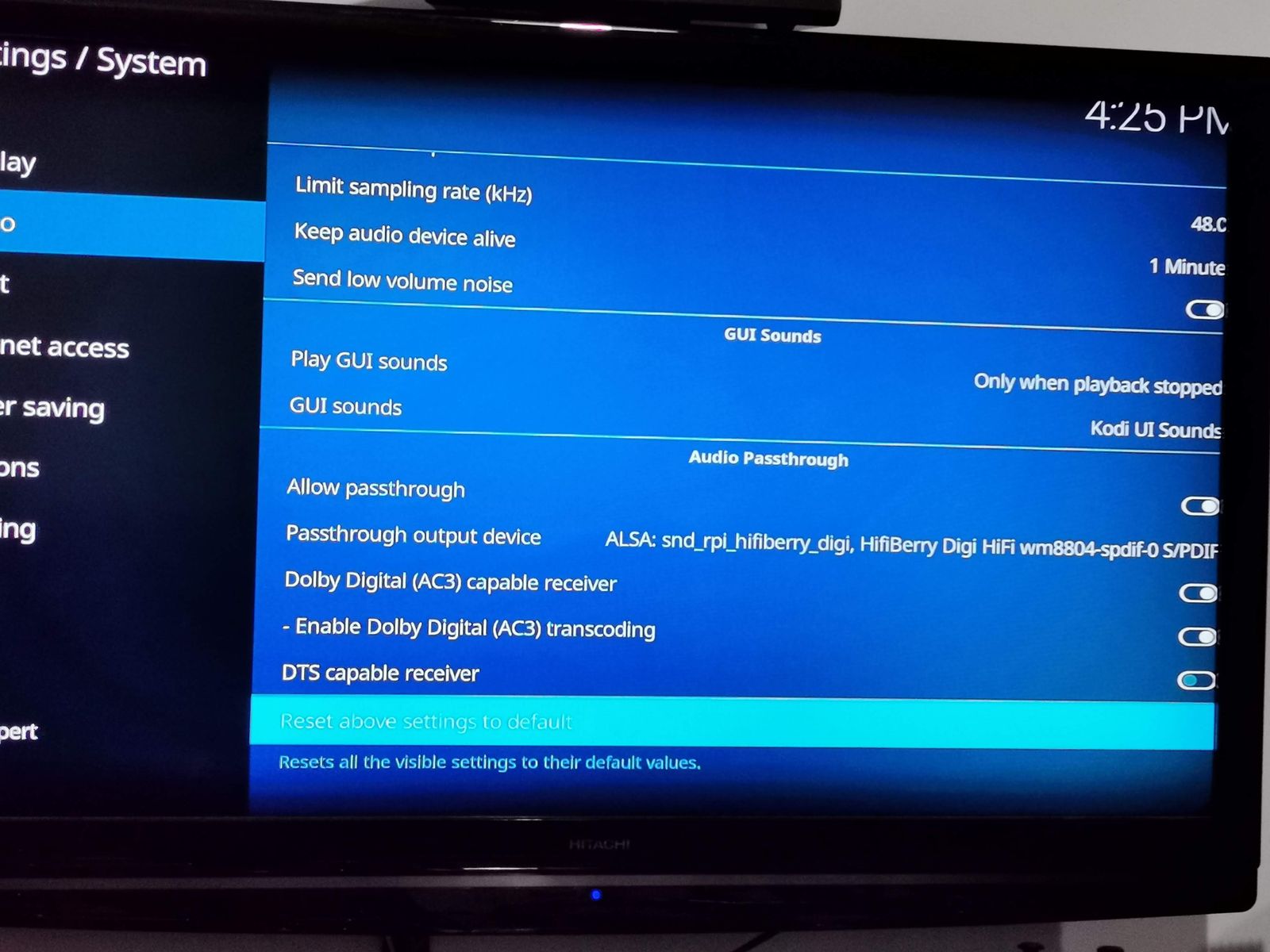

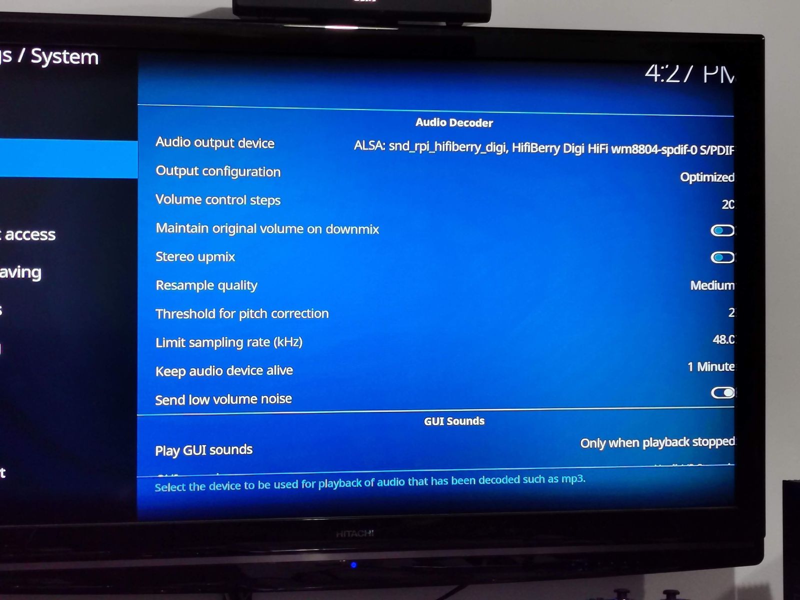

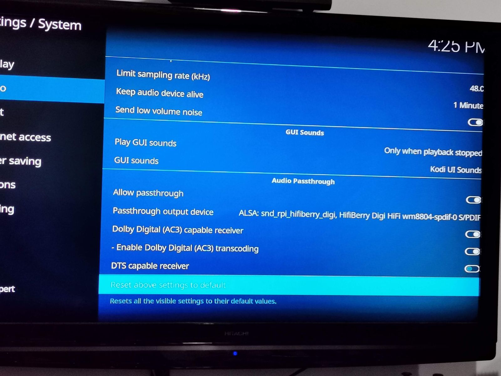

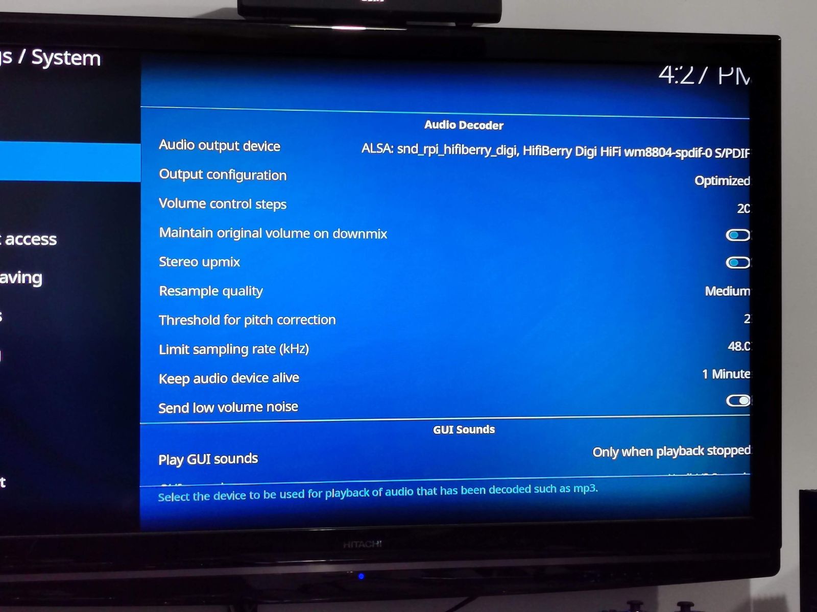

  • Hey, I'm running LibreELEC 9.2.5 on a Pi4 with a HifiBerry Digi+ outputting over optical SPDIF to a 5.1 surround amp. My SD card died over the weekend so I had to reinstall everything and restore from a backup.
    Ever since then, all of the audio for the centre speaker has started coming out of the subwoofer instead of the centre speaker. The LFE channel is also coming out of the sub, so it's not just a simple case of swapping the speakers over, and since it's a single SPDIF cable there's nothing wrong hardware wise.
    My amp is an AC3 capable one, and transcoding is enabled in the audio settings. Without that turned on it doesn't even output 5.1 at all, and instead defaults to straight stereo.
    Does anyone know if there are any internal driver or config files that I can check? There are no settings within Kodi itself that I can change, there's no channel mapping at all.

  • My amp is an AC3 capable one, and transcoding is enabled in the audio settings. Without that turned on it doesn't even output 5.1 at all, and instead defaults to straight stereo.
    Maybe that's the wrong setup. Try pass-through without transcoding. At /storage/.kodi/userdata/guisettings.xml:
    <setting id="audiooutput.ac3passthrough" default="true">true</setting>
    <setting id="audiooutput.ac3transcode" default="true">false</setting>
  • Maybe that's the wrong setup. Try pass-through without transcoding. At /storage/.kodi/userdata/guisettings.xml:
    Modifying the xml file didn't save the change for some reason, it just reverted back as soon as I rebooted. When I turned off transcoding in the GUI I only got 2.0 stereo with nothing coming out of the sub at all. Looking at what the info in the GUI says, it reckons transcoding should be turned on if I'm using SPDIF. My setup doesn't support PCM multichannel over HDMI, hence the extra soundcard.
