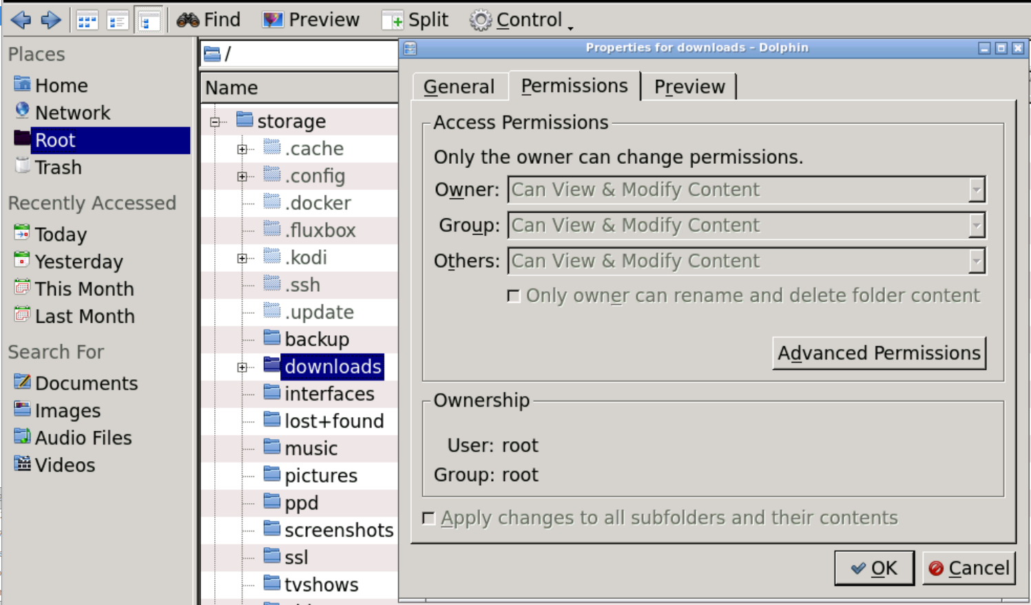

    I can only cut & paste within the <downloads> folder - and it's SUPER FAST, 10gb in 30 sec (compared to 12mb/s if I do it across SMB).

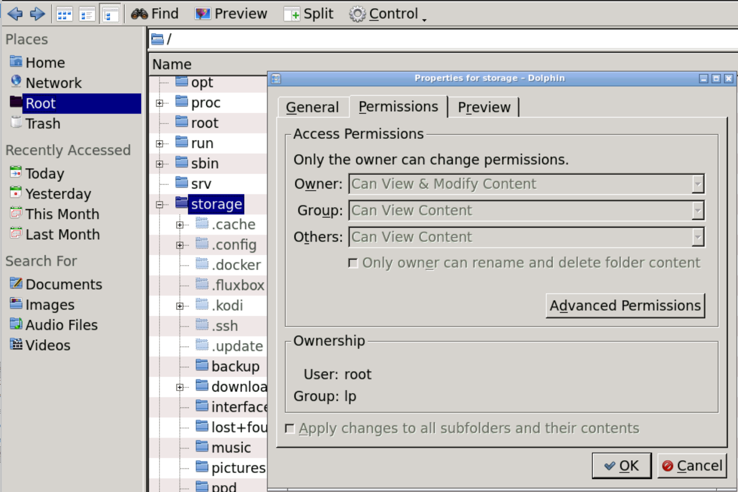

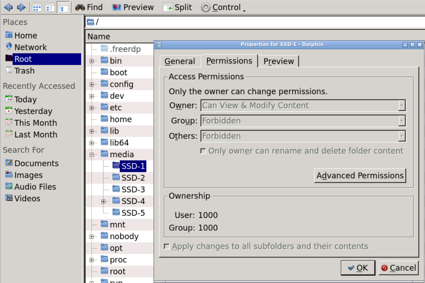

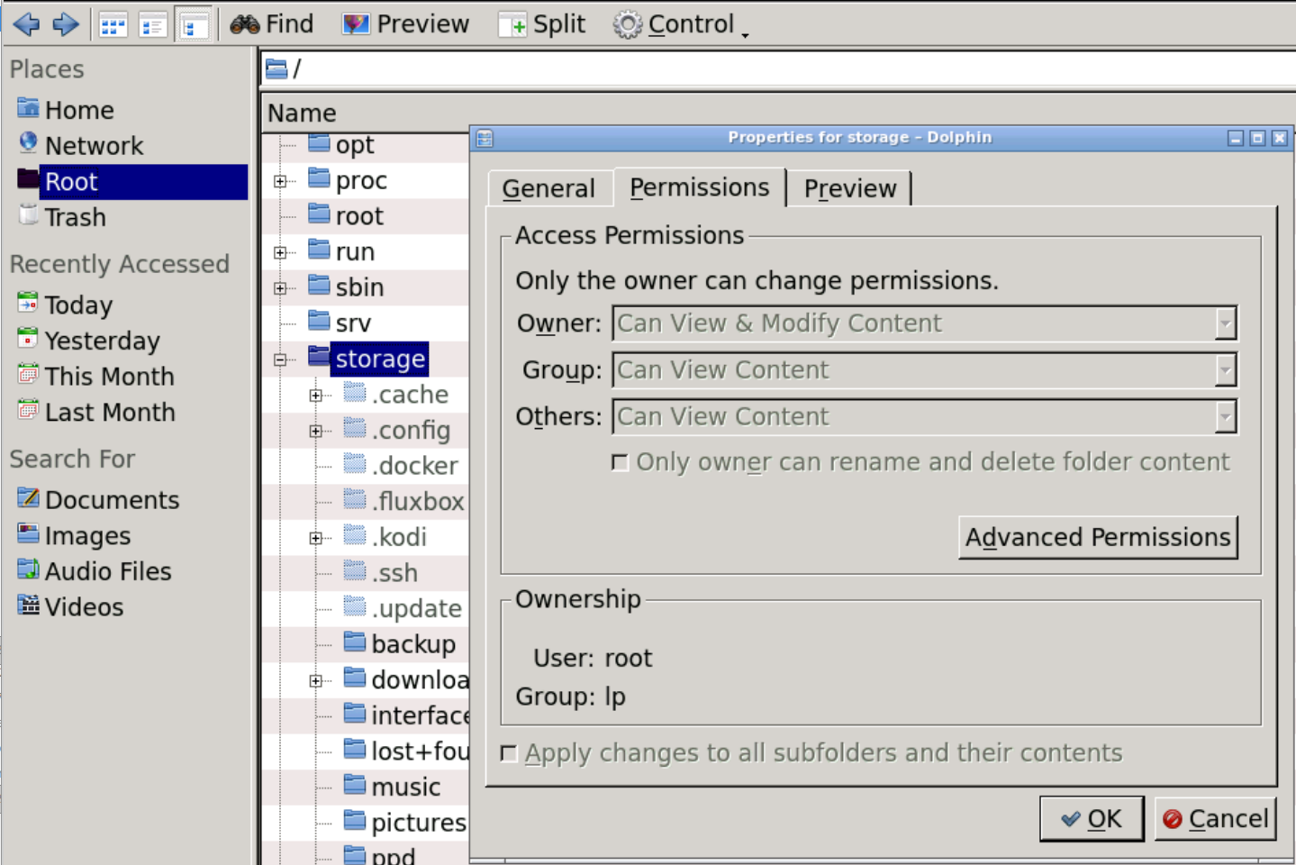

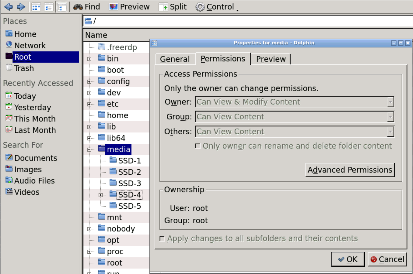

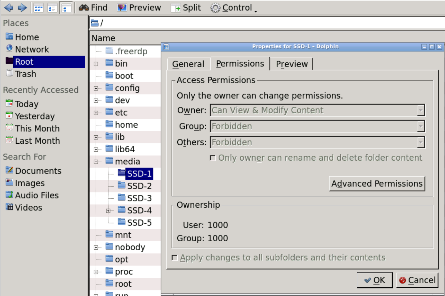

    Strangely, the <media> folder is owned by root, but the SSD's in that folder are owned by 1000 (nobody?).
    The <downloads> folder is owned by root, as mentioned above I have no problem cutting/pasting anywhere in that folder.
    Here's the screenshots:

    2) When I'm using Dolphin from docker I cant read only 2 out of 5 USB disks in the <root/media>.
    However, I can NOT "paste" into any subfolders,
    My screenshots 1 and 2 above show the <root/media> folder is owned by root, and one would assume that this ownership will be recursive to subfolders (i.e. SSD's). But no - they are owned by User 1000 Group 1000 - please have a look at the Dolphin screenshots in my previous post.
