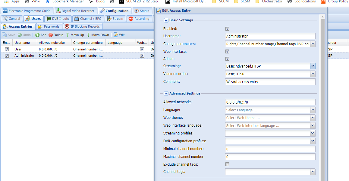

  • go to Configuration~Users~Access entries and click on the account you r using...in this case administrator then click edit...and check that the streaming profiles you r using are all enabled for that user..I have a feeling htsp is not enabled properly and your setup is defaulting to some transcoding profile..
    Menu looks like in this image:
    m1zvLaD
    m1zvLaD
    Just checked and all profiles appear to be enabled.

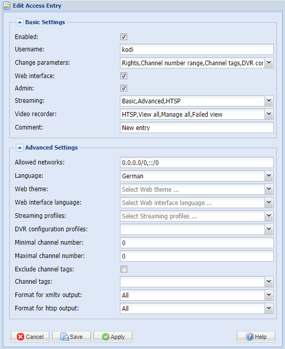

  • this is my kodi user (Tvheadend 4.3 so likely a bit different), at Change parameters: tick everything besides HTSP Output Format then the user should just work
    if this is still not working we can manually remove usersettings and it might work again too (I need access to my pc to tell you the details later)
  • Just checked and all profiles appear to be enabled.
    Streaming Profiles and Dvr Config Profiles you have nothing set for the user in that screenshot..most probably that is your issue..
    Also in Video recorder I would tick everything.
    Connection limit type...choose all
  • Using Kodi on Nvidia Shield with a HTSP steaming profile appears to be working and channel switch time is down to like 3 seconds, which is great and thanks for your help.
