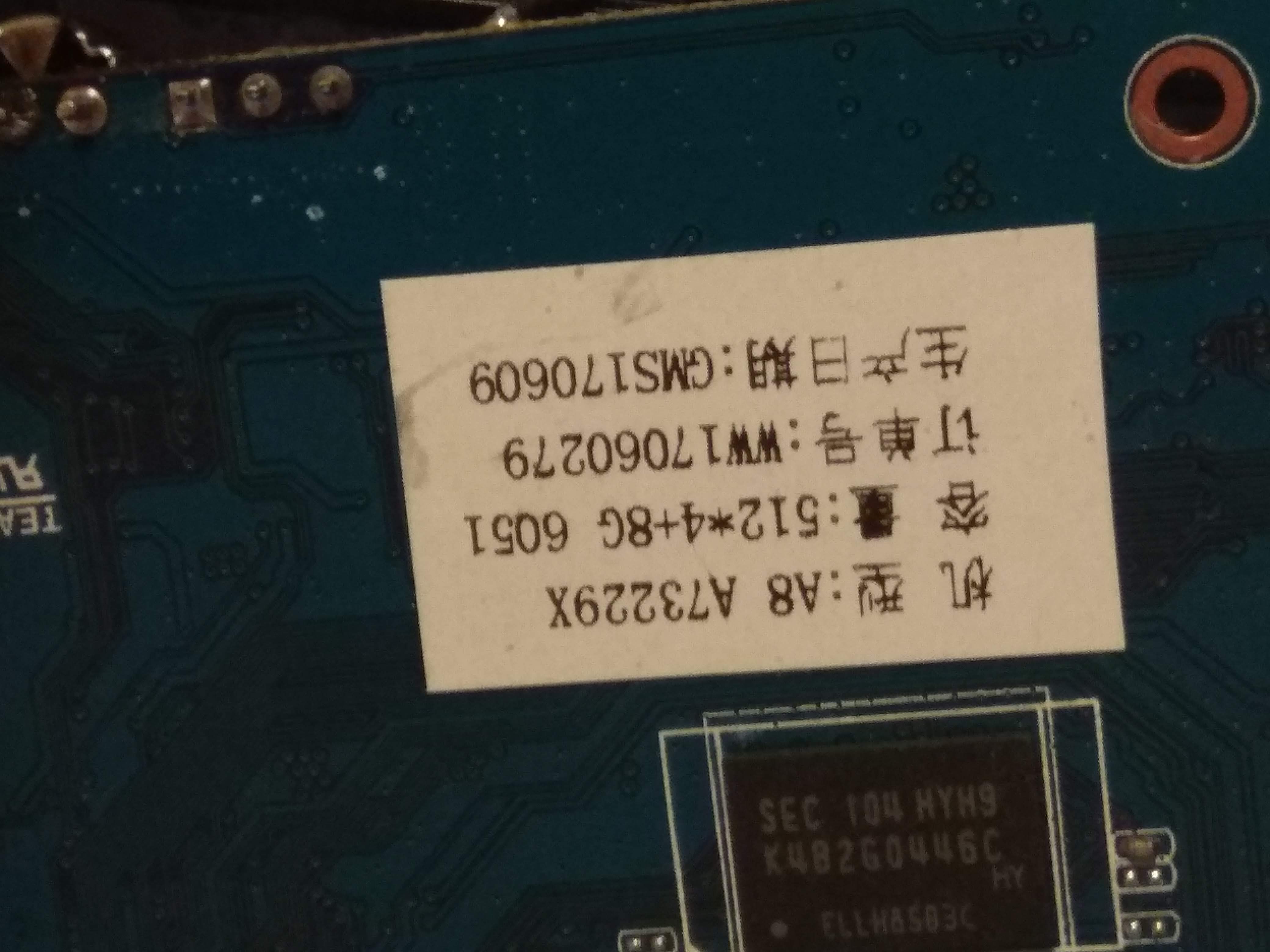

  • Thank you friend! This is a little complicated for me. He left the android and configured the built-in RCMC-KODI there. The prefix is not mine and I will not risk it. The seller sent a fake prefix. The processor is 3229 instead of 3228, as it was on the site in the specification. There is no 5GHz. Nevertheless thank you.

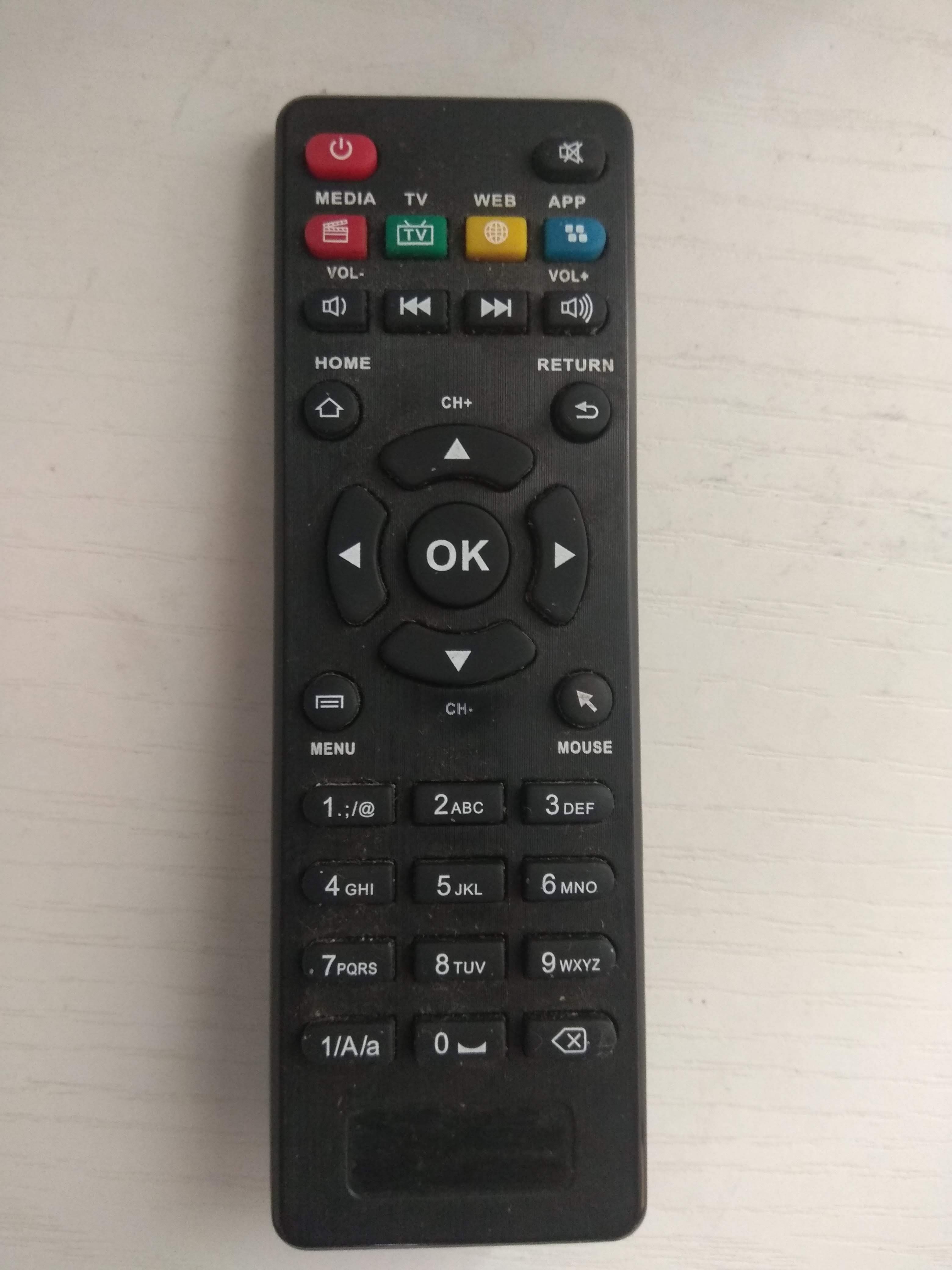

  • zampedro I have an A95Xr1 with rockchip 3229 and the remote in the picture above, but dont work whith this LE rom.
    I don't know were find the right keytable.
    I've tryed with other confg files taken from the list posted in a topic of remote similari at mine and sold for many different boxes
  • Newbie here. Same problem, remote doesn't work on my A95X 3229 and i don't know how to do it myself . Can you please help ? Maybe you an image to download with the changes already done ?
