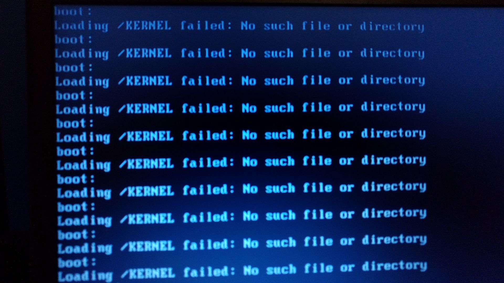

1. The kernel file can not be opened. But the legacy image was only created to in case the usual GPT disk is not possible.
2. The size of the used stick is unknown so we start with a small 32MiB file system that is expanded at first boot.
The filesystem repair may have been started because you pulled the stick before any data was flushed.

1. I first Rufus installed the legacy img which showed only one drive, USB (D:), invisible contents. Copied AE 10.0.9 Kernel + System (already had a copy in Downloads folder), changed syslinux.cfg to DEFAULT run, and rebooted.
Unlike your first legacy boot img (which resulted in straight to Windows boot, no messages), I got errors this time after typing in run. See pic attached.

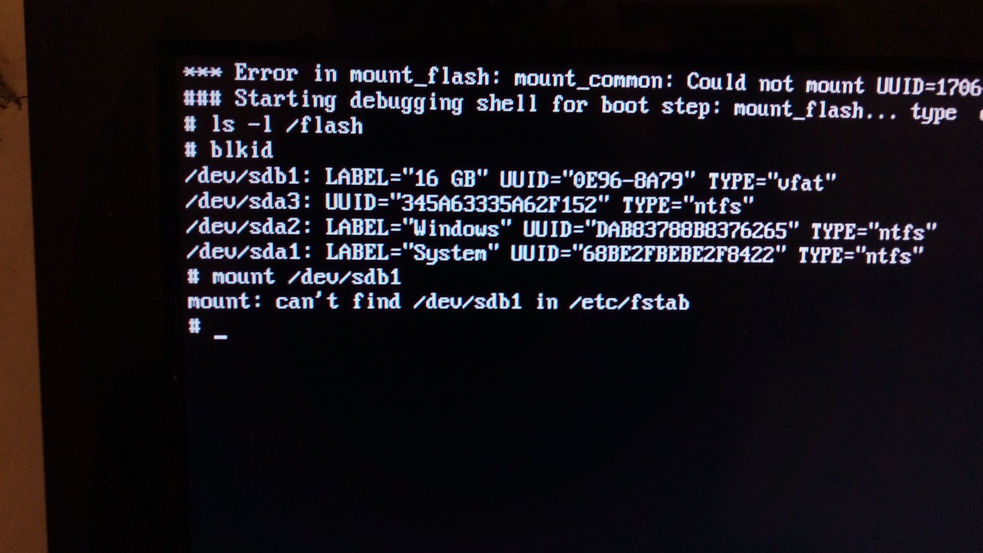

1.) The randomly generated UUIDs can be read from any linux system and then stored in the syslinux.cfg. LE is not using /etc/fstab.
boot=/dev/sdb1 disk=/dev/sdb2 is possible but not reliable because it depend on the disk initialization order. Another possibility is to use boot=LABEL=xxx disk=LABEL=yyy if the file system labels are defined.
The UUID was not incorrect, it still pointed to the original file system of the copied syslinux.cfg

1. So that means one cannot configure a mountpoint etc in the LE .img file before boot, obviating need for manual UUID discovery at debug shell at boot time?
That is, mountpoint needs to be created in the LE.img file first by author in /etc/fstab, (or by user via ssh in bootable LE, then backed up) e.g., sdb1 could point to the first USB attached.
Then in syslinux.cfg, boot=disk= /dev/sdb1.
Why was the UUID incorrect in first place? Just a generic entry?

1. No luck with your boot method: this time the laptop just hangs at the Dell splash, much as with the old Dell PC case in OP.
