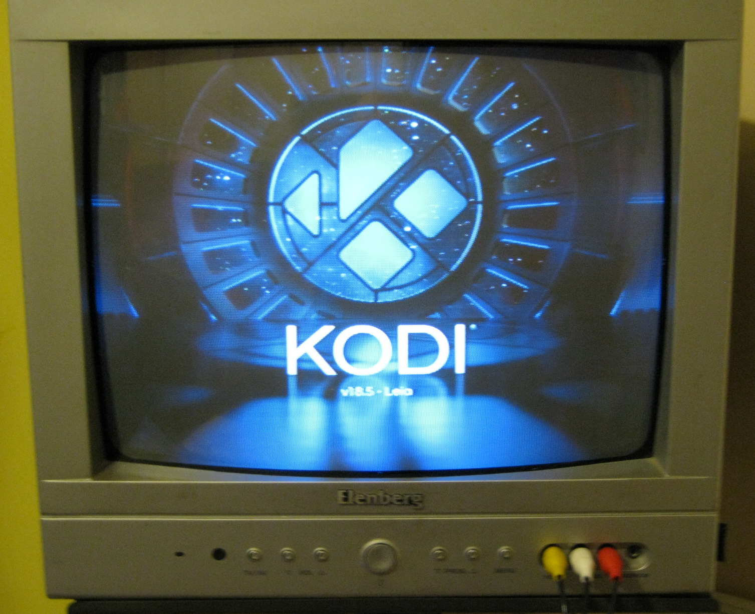

My very first box mars2 on the shelf at least 2 years waiting for LE because its too slow and buggy on Android![]()

I didn't mention it before: In the current images to analog av-port is deactivated, since on some devices/tvs the hdmi signal isn't dected correctly and the ouput is defaulted to tve.
I couldn't test it before - but user k7k8 just confirmed enabling it works and tve output is working too ... in the upcoming images i will try to find a way to make it autoselect

I finally got rid of this annoying bug, that kodi was stopped after 10 minutes "automatically" - or the flickering screen on 4K-Display (which also happend exactly 10 minutes afer bootup) - I also added autodetction for HDMI/Tvout - you don't need any devicetree moification anymore, if you want to use tvout. For this reason the "splash" screen is now set to 1920x1080 for HDMI output (hardcoded), since the HDMI-phy won't automatically detect a signal on any higher resolution. Kodi itself will start in higher or lower resolution... whatever your screen supports.
If your screen does not support 1080p you will see only a black screen before kodi starts for this reason (HDMI only)

Bluetooth is now enabled and should be autmatically brought up (on supported chipsets, rtl8723b, ap6xxx)
Added support for RK3228 Devices - this and more: see [unoffical] LE-9.2-Images for RK3229/RK3228
k7k8 :
HDMI IN is not possible ... but HDMI OUT is ,,, just try the new images ... you don't need to replace the dtbs any longer
