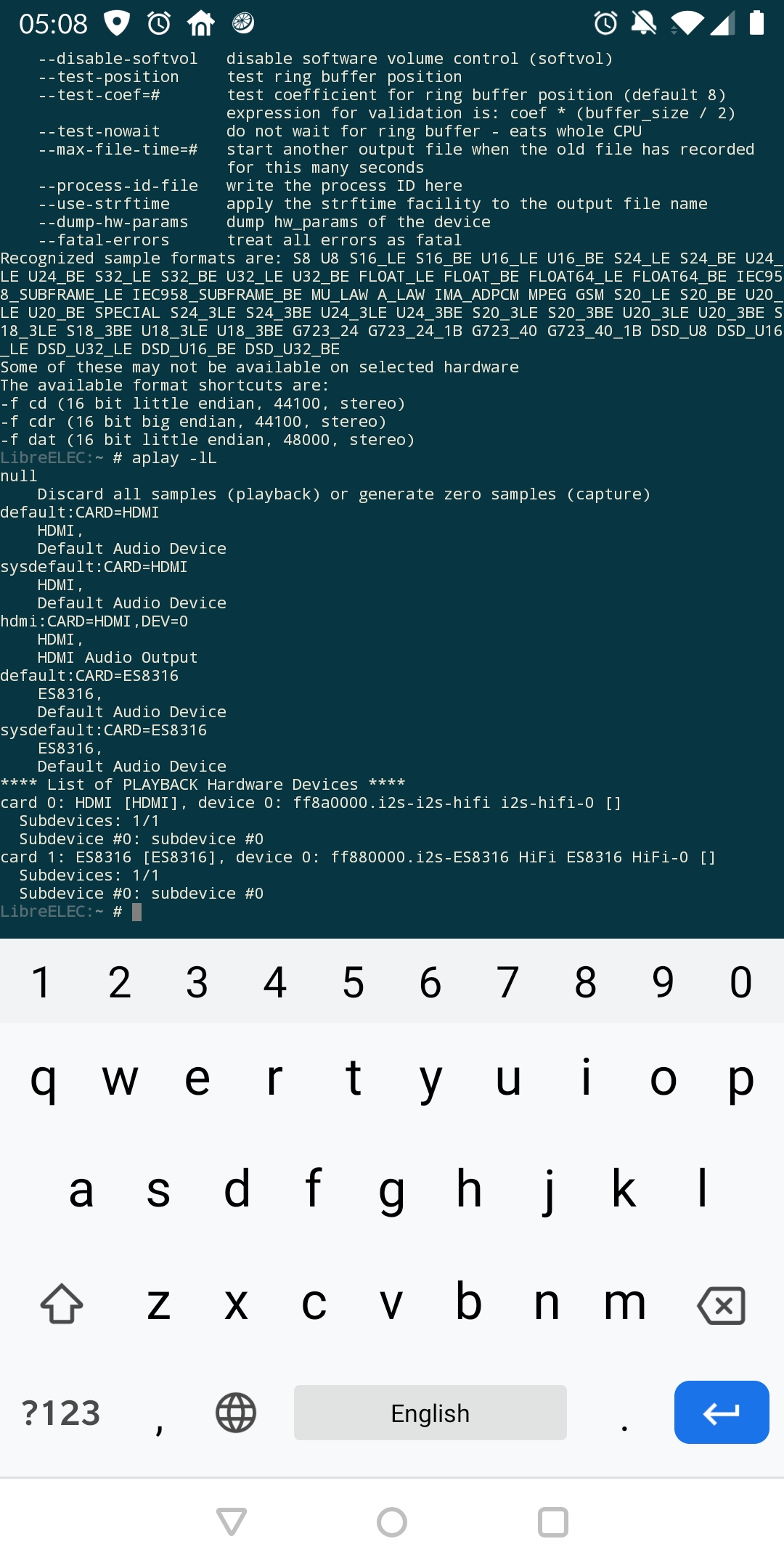

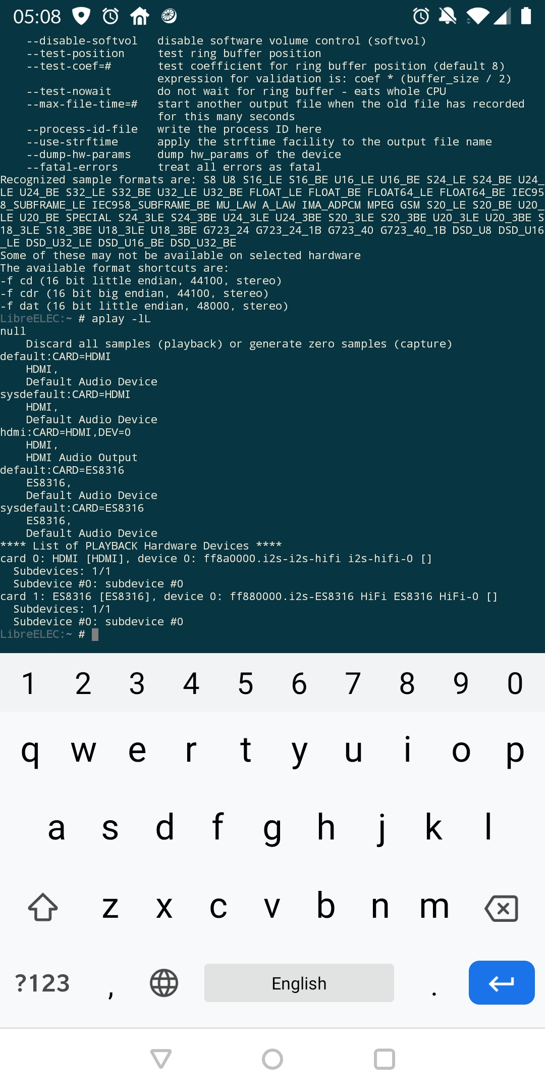

  • Hello I have a rockpi4b sbc with libreelec LibreELEC-RK3399.arm-9.1.501-rock-pi-4.img.gz installed. I have problems enabling audio out from the analog 3.5" jack directly from libreelec. I get only audio from HDMI or if I plug a USB dac.
    I have tried HDMI, analog and ES8316 analog and nothing seems to work.
    if I run allay -lL I get the options indicated in the attached pictures. Please advise to enable analog out.
