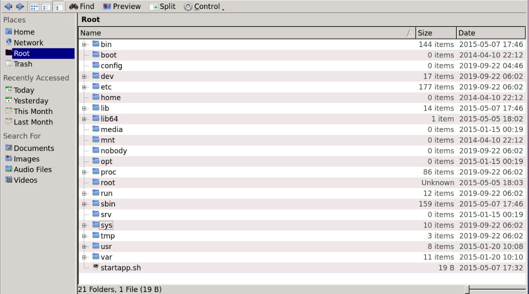

    I've installed Dolphin container using Portainer, but I cannot see any mounted drives under "media" (the folder is empty), nor do I see the "downloads" folder, probably because I'm logged in as nobody:users (99:100)
    My CLI access to LE is through PuTTy (as root). I can't find any "edit" option for the dolphin image to change my login to "root" via Portainer
    If I use Putty - where do I find the Dolphin's config file to edit it with nano?

    Change the environment variables user_id and group_id to 0 so it runs as root
    What locations did you mount? Did you use bind mount in portainer?
