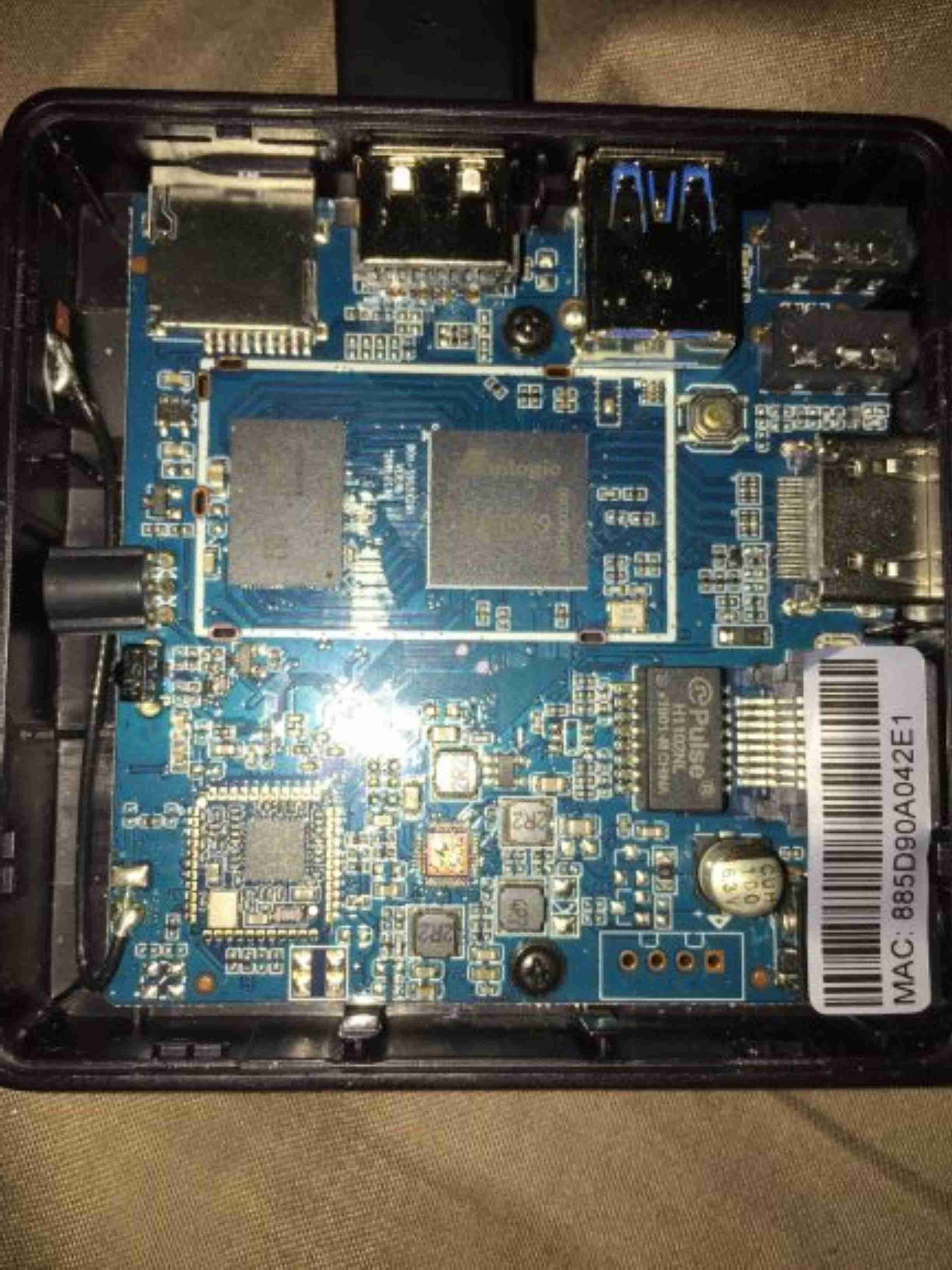

What build are you using?
This is build i'm using,LibreELEC-AMLG12.arm-9.80-devel-20190724161814-893dd58-s905x2.img.gz. In this build I don't use dbt.img. The remote control works, it would be perfect if the lan and the wifi worked. Coreelec: CoreELEC-Amlogic-ng.arm-9.1-nightly_20190725-Generic.img.gz. Wifi and lan is worked. -
This works for older versions with kernel 5.2. you can:
-Downgrade to image 20190716
-Wait until I compile another version for 5.2.1
Done
Please try this
Release RTL8189ES with kernel 5.2.1 · CGarces/LE_WiFi_Drivers · GitHub
Just get the zip file and install as addon.
Sorry, I don't get you.
Works fine on SD but not after install to internal?
Try to install again the addon. I never tried to install to internal an alpha version.
Never install a non-stable Version to internal.
“Stupid is as stupid does.” – Forrest Gump
New Build Contruction -8/23/2019, but Wifi and Ethernet no working. Programers, please take one moment resolve this fail situation, Thank You
Hi.
Please note that not is a "fail situation", there is nothing to fix, the test images from balbes150 not support RTL8189ES. I provide the addon just as proof of concept and only because it need it for my own use.
I have build a new version with kernel 5.3rc-8 that should work with image 20190902 from balbes150
Hi.
Thanks, it works very well. I thought that the images of balbes150 were intended for any user. It's a shame, because all the changes that babe150 makes will not be available.
