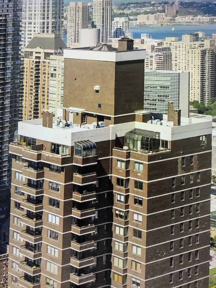

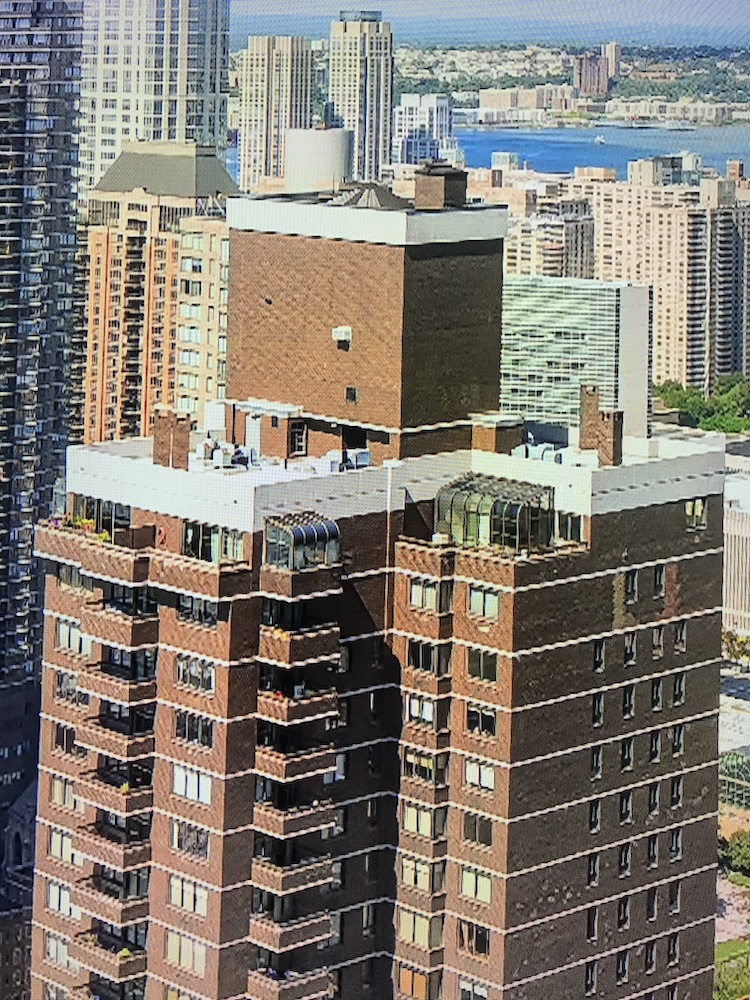

    Now that i got a 4k TV, I tried it out by playing the following 4k demo LG: New York HDR UHD 4K Demo | 4K Media.
    I noticed in the 2nd scene, especially the tall brown building in the front, aliasing on the borders of the windows.
    When I play the exact same file with VLC on Windows 10 it is much smoother without any staircase effect.
    Now I thought maybe my settings are somehow messed up, because of alle the update migrations,
    but also on a untouched 8.90.015 there is the same effect.
    I added two pictures, one taken from the "untouched" LE 8.90.015 and one from VLC with my phone.

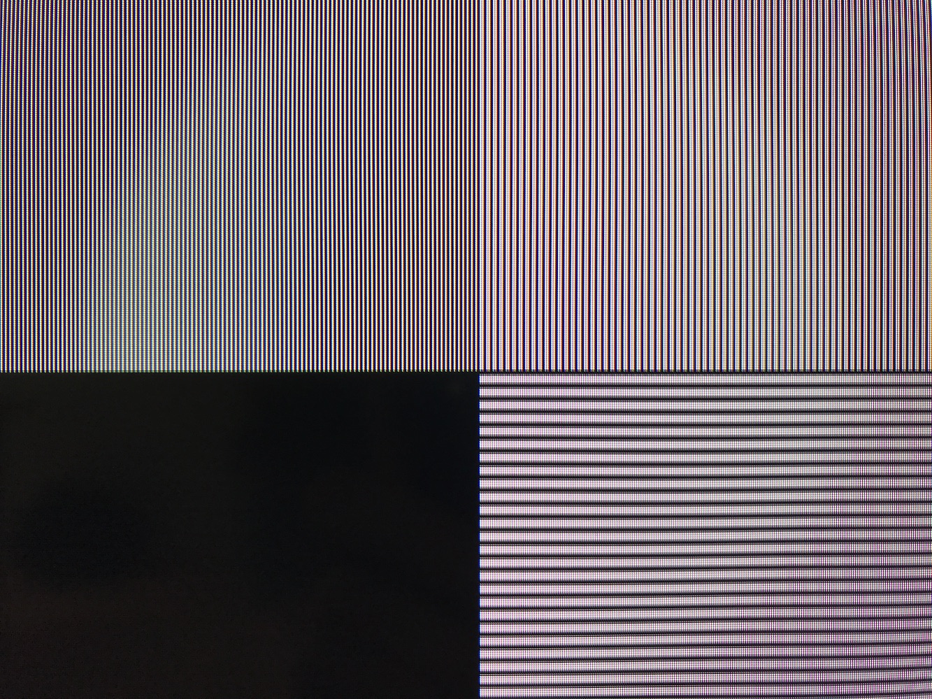

    Edit: Okay, just did another test with both my everyday LE and the untouched:
    I made a short 4k clip of this test picture and played it on both.
    The upper section looks as it should (except light green hue) -> the lines on the upper left section are 1 pixel apart, but it seems like the horizontal decoding is wrong.
    (very close up capture)
    Because both show the same result, I think my settings do not affect this and it might be a general decoding error...

    I tried the demo and I confirm that I see the same thing. I tried the same demo on my RockPi4 and again I see the same problem. Finally, I play the demo on my Minix U9-H running the last version of CE and the picture is perfect. The aliasing is evident on the last picture of the demo, the LG logo.
