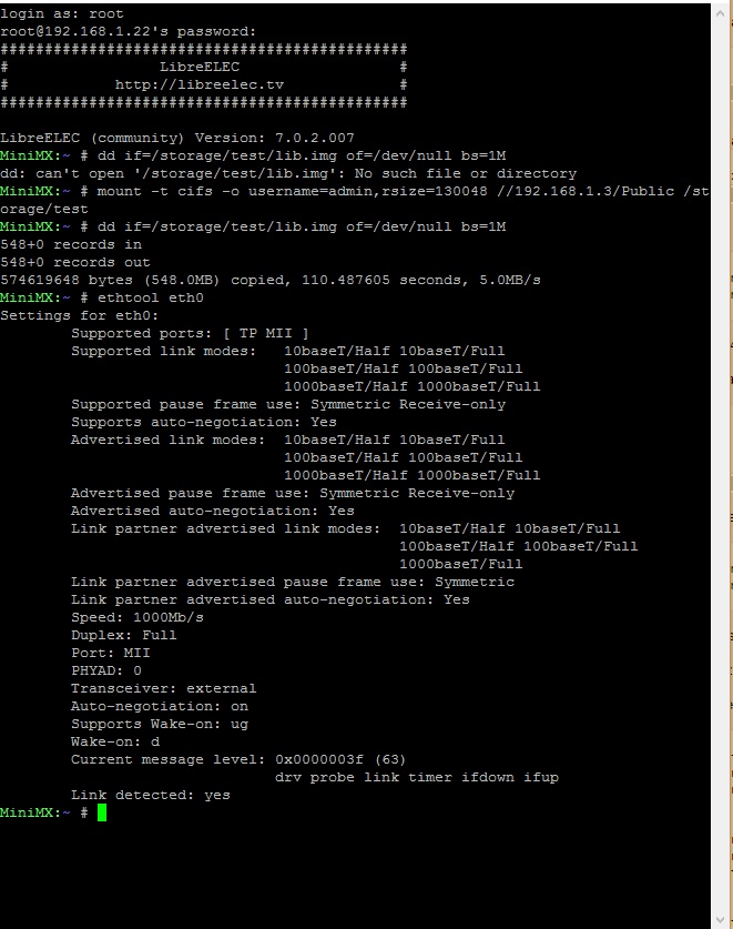

  • I have 2 MiniMX 1/8GB with latest libreelec on nand.
    The ethernet adapter show working at 1000M (gigabit):
    MiniMX:~ # ethtool eth0
    Settings for eth0:
    Supported ports: [ TP MII ]
    Supported link modes: 10baseT/Half 10baseT/Full
    100baseT/Half 100baseT/Full
    1000baseT/Half 1000baseT/Full
    Supported pause frame use: Symmetric Receive-only
    Supports auto-negotiation: Yes
    Advertised link modes: 10baseT/Half 10baseT/Full
    Advertised pause frame use: Symmetric Receive-only
    Advertised auto-negotiation: Yes
    Link partner advertised link modes: 10baseT/Half 10baseT/Full
    1000baseT/Full
    Link partner advertised pause frame use: Symmetric
    Link partner advertised auto-negotiation: Yes
    Speed: 1000Mb/s
    Duplex: Full
    Port: MII
    PHYAD: 0
    Transceiver: external
    Auto-negotiation: on
    Supports Wake-on: ug
    Wake-on: d
    Current message level: 0x0000003f (63)
    drv probe link timer ifdown ifup
    Link detected: yes

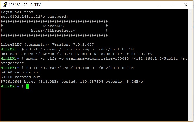

    Dev null:
    Eth:
    My NAS is WDMyCloud with gigabit, and with pc, and notebook i can read from nas 80-100MB/s

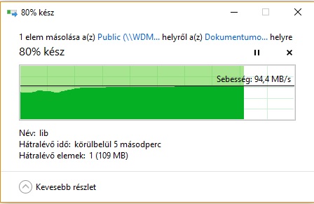

    My slow laptop copy to ssd from nas the same file:
    Edited once, last by envagyok (September 22, 2016 at 8:08 PM).

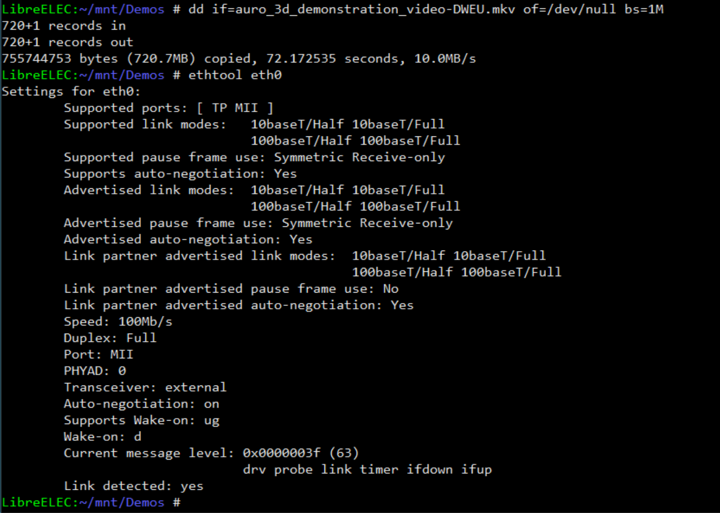

  • For comparison a read from my NAS (dedicated server with raid-6 and gigabit).
    My S905 box has 100 MBit/s only, so this is very decent performance.
    Can you force your box to 100 MBit/s to see if anything changes?

    Then copx to dev/null to 9 and 43 MB/s
    Then mount again my wdmycloud, but without rsize parameter:
    mount -t cifs -o username=admin //192.168.1.3/Public /storage/test
    Then copy to dev/null with 32MB/s, what is better result.
    What is the best mounting option to my wdmycloud?

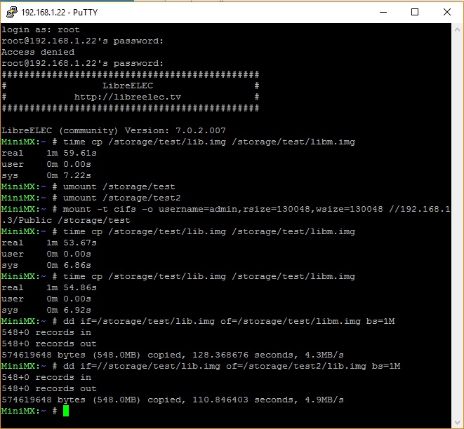

    CPU 2-3%
    The speed with this parameters worst than without prameters
    MiniMX:~ # umount /storage/test
    umount: can't unmount /storage/test: Invalid argument
    MiniMX:~ # mount -t cifs -o username=admin,rsize=16384,wsize=57344 //192.168.1.3
    MiniMX:~ # dd if=/storage/test/lib.img of=/dev/null bs=1M
    548+0 records in
    548+0 records out
    574619648 bytes (548.0MB) copied, 32.524298 seconds, 16.8MB/s
    MiniMX:~ #
    mount without rsize,wsize i reach 40-42MB/s with 3-4% cpu

    I think the problem is with nas, but then why makes to me with windows machine 90+MB/s copy speed to real ssd storage, not just /dev/null, as miniMX
