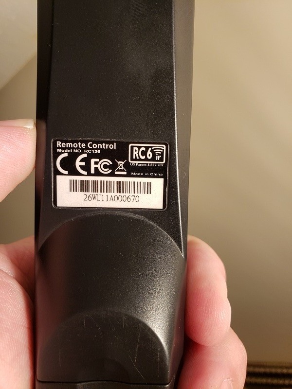

    Hello All ! I am fishing to see if anyone else has seen similar behaviour.
    Clean install of LE9 on 64GB SSD. ASUS AT3N7A-I board 4GB RAM. Formosa Industrial Computing, Inc. Infrared Receiver [IR605A/Q] and RC6 MCE Remote (bundled).
    The Behaviour : Remote functions perfectly as long as I keep pressing buttons and navigating menus, etc. If left alone (leaving the room) or running any playback for 10 minutes or so, the remote becomes lagy (by up to 2 seconds at times) and acts as if buttons were double pressed and does not come back to normal until reboot.
    Now my first thought was that the usb port goes to sleep or something. Connecting a wireless multimedia keyboard/mouse combo does not recreate the issue.
    I first noticed this happening with a previous LE release, but gave up and just used a keyboard hoping it would get straightened out in LE9. No such luck.
    I can post logs but thought I might just ask around first to see if anyone has seen this before.
    Interestingly enough, when running this setup "live" from the LE9 installer media the issue does not seem to occur.
    This remote also works as expected on another ION board running KodiBuntu (don't laugh please :p ) that I update regularly via SSH per KODI wiki and is current, and a Windows 7 machine.
