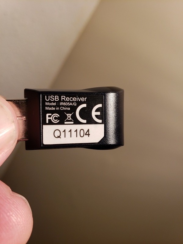

    Clean install of LE9 on 64GB SSD. ASUS AT3N7A-I board 4GB RAM. Formosa Industrial Computing, Inc. Infrared Receiver [IR605A/Q] and RC6 MCE Remote (bundled).
    The Behaviour : Remote functions perfectly as long as I keep pressing buttons and navigating menus, etc. If left alone (leaving the room) or running any playback for 10 minutes or so, the remote becomes lagy (by up to 2 seconds at times) and acts as if buttons were double pressed and does not come back to normal until reboot.

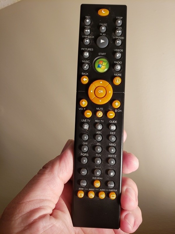

    Hello HiassofT and Schreibwaise,
    It is a Mediagate Rc126 (MG-IR01BK)...This One
    The LED indicator does light to show signal being received while the lag happens.
