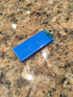

  • I have just received my Rock64 SBC. I ordered a Premium Aluminium Casing and am just wondering if anyone has had any experience installing the thermal pad onto the Heat Sink that comes with the case?
    It seems to have tape on both sides of the thermal pad; one is blue tape, the other is clear. How do I install this? Which side gets stuck onto the heat sink? Unfortunately the case didn't come with any setup instructions. I have created a ticket with Pine64, but have not hear back.

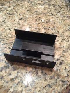

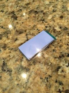

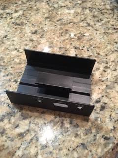

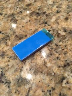

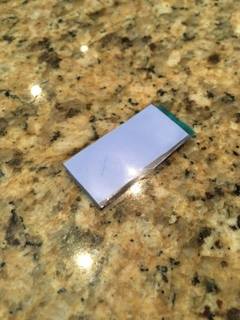

  • Thanks for responding buzzmarshall. I think that i'll just peel both protectors off and stick it on. As both sides have the protector and are therefore "sticky" does that mean that once I install the thermal pad I won't be able to remove the lid on the case? The heat sink is attached to the lid, so once I install it, the thermal pad will be attached to both the lid and the cpu...
    I've put some photos of both sides of the thermal pad and the lid of the case with the integrated heat sink
  • normally that stuff comes apart fairly easy if you don't just rip it fast when taking it apart. so you should be ok if your carefull when removing the lid.
    ya thats not really the best thought out approach but seems typical of a lot of makers.usually it only breaks and tears if its getting old and been overheated alot.
    I usually see that type because you can buy it in various thickness's where they are trying to use the heat sync on more then just the main cpu and it will be applied to help make up for the gap between the other chips and the bottom of the heat sync caused by the main cpu sitting up higher then the other chips once the heat sync is sitting down on the cpu.
    eg: i notice on my rockpro64 that the heat sync once on leaves a small gap between the tops of the memory chips and the bottom of the heat sync and if i was worried about heat it would be ontop of the 2 memory chips that i would apply a small pad of the right thickness of that type of material.
