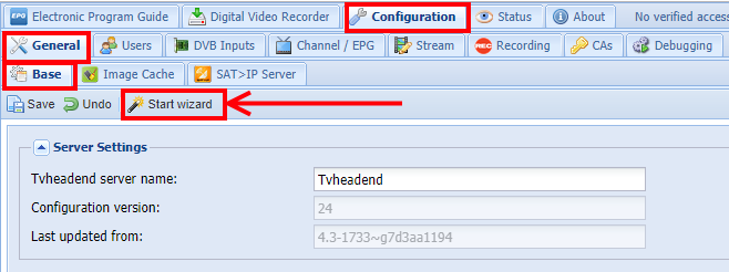

I just downloaded and installed LE9. It recognizes my tuner as a LG Electronics tuner?? Now it still doesn't see any stations. I may have messed up during the wizard install. How can I delete my existing stuff and start from scratch on the wizard?
- Official Post
you can just remove it at the kodi addons (tick yes pls remove all userdata) - reboot
install again, should work or you start it manually
