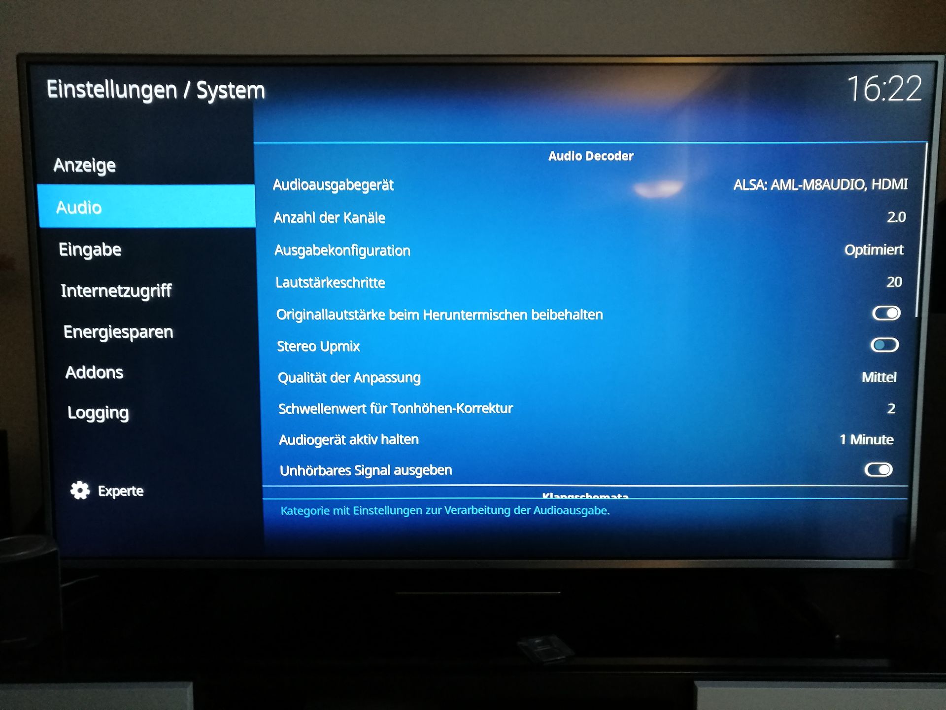

    Kodi settings:
    - audio device AML-M8AUDIO HDMI
    - AC3 and DTS passthrough enabled
    - other settings -> Screenhots
