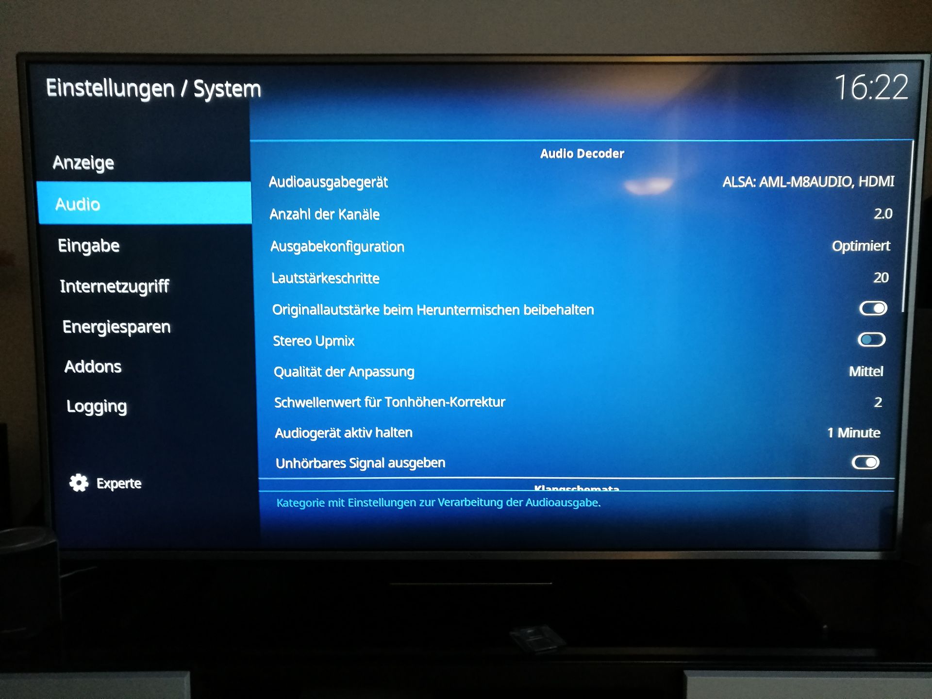

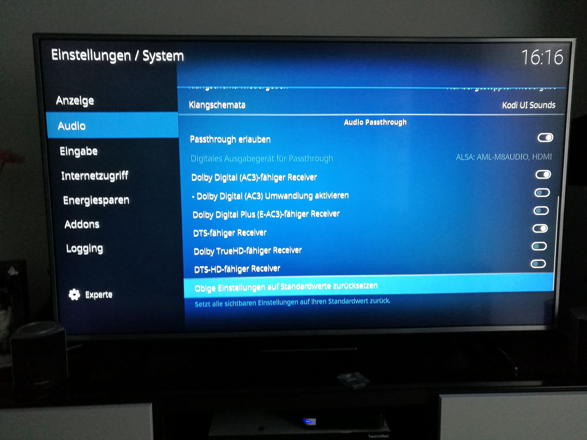

    Then used a LE9 fresh install.
    Kodi settings:
    - audio device AML-M8AUDIO HDMI
    - AC3 and DTS passthrough enabled
    - other settings -> Screenhots
    All videos with AC3 and DTS have no problem, because of the direct passthrough.
    Other videos with an audio sample rate of 44.1 kHz also seem to work, tested 2 files with it.
    For all other videos where the audio stream has a sample rate of 48 kHz I get no audio, tested videos with audio codecs AAC or mp3.

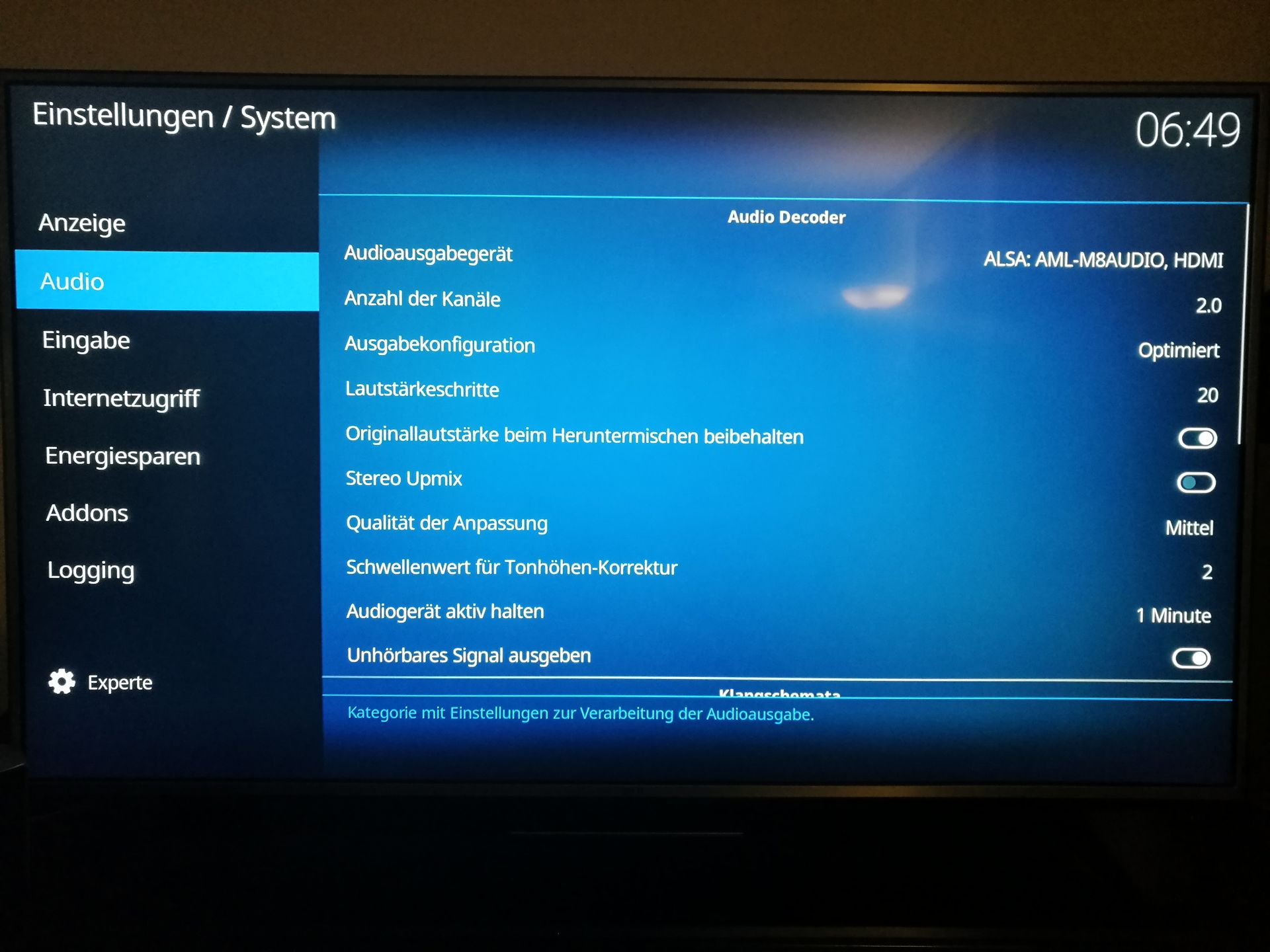

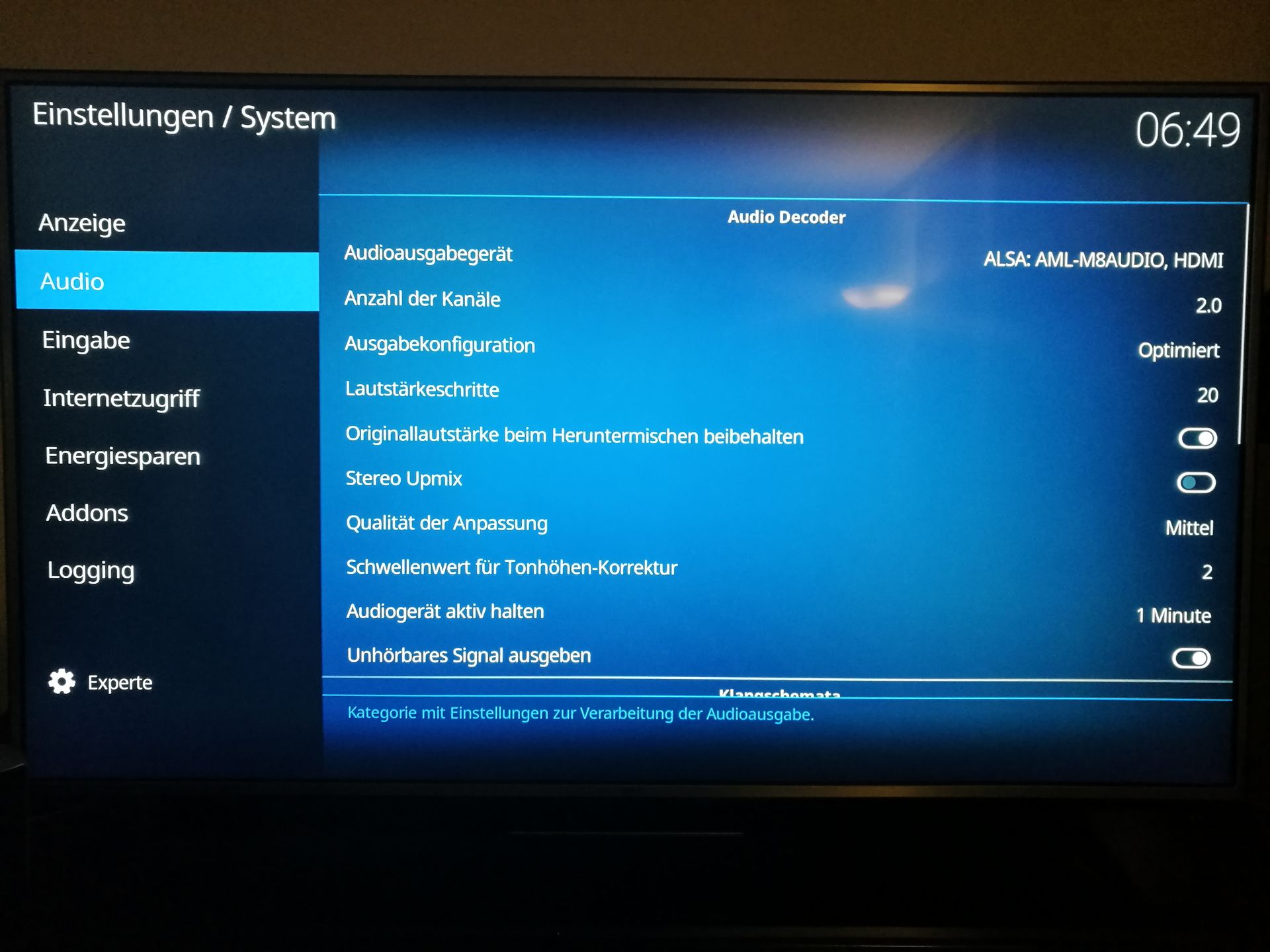

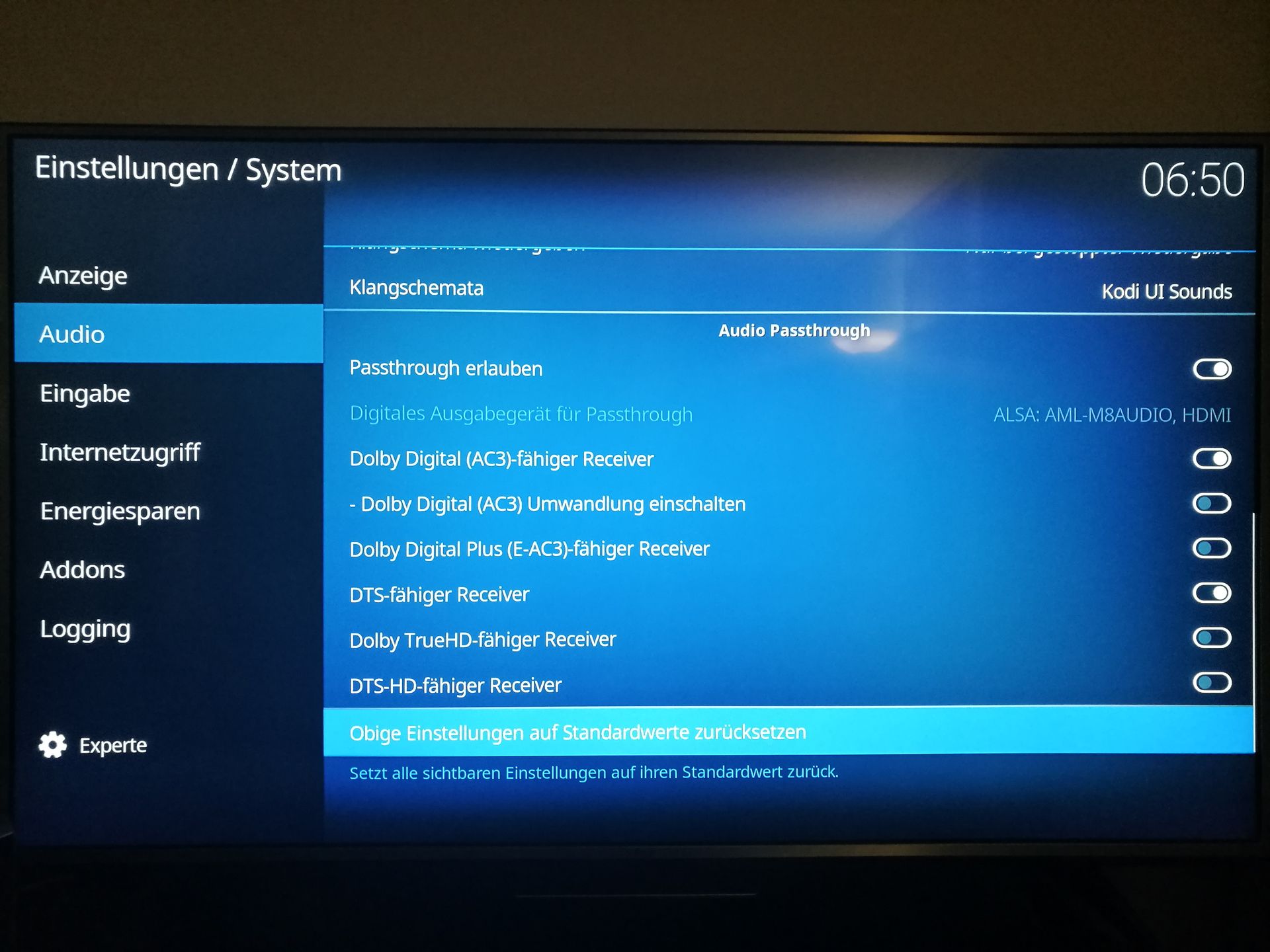

    I have a similar problem after upgrading to 9.0:
    A WeTek Play 2, connected via optical out to a pioneer receiver.
    AC3 and DTS passthrough enabled in the Kodi settings. AC3/DTS works, but all other audio not. Tested with TV streams from TVHeadend and other video files.
    In 8.2.5 there was no problem with the following settings (it is in german, sorry):
