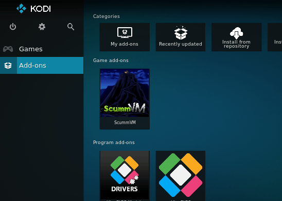

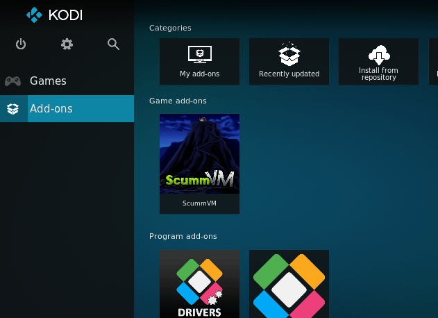

I installed le 9 on my Intel nuc, so far everything seems to be fine, but i can not Install any plugins from the le Repo, it is just empty...
Any ideas?
