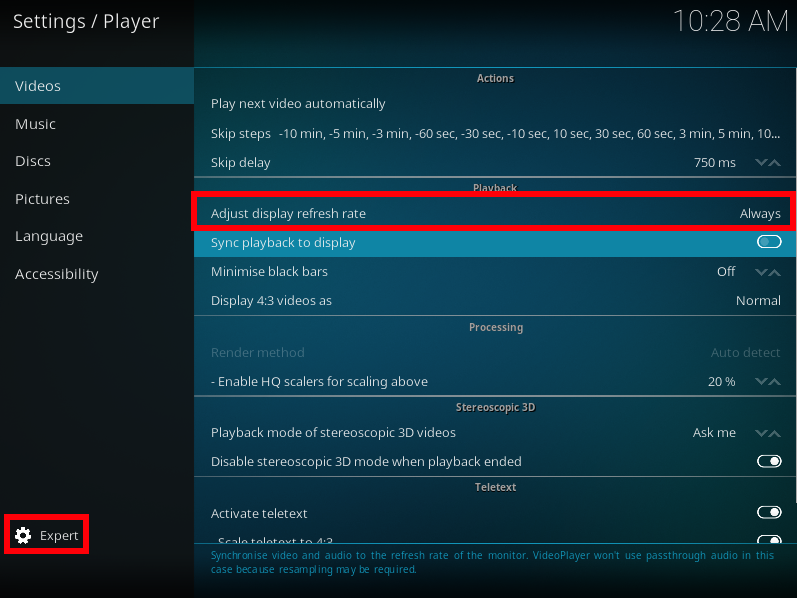

"perfect" settings are (FHD + DVB at the EU)
set the Kodi Gui to 1920x1080, set to 50 Hz.
whitelist 1080p/60/50/23,98
and pls try again - you should have similar speeds to LE8
Hi, I tried again, with the above white listed and |GUI st to 50hz, managed to get decent channel changes between standard definition channels but slow between HD channels or from SD to HD.

yep I tried both always and on start stop, It is working perfectly on 8, set to always or start stop but on 9, very slow channel switching.
