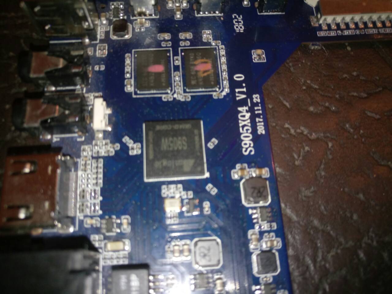

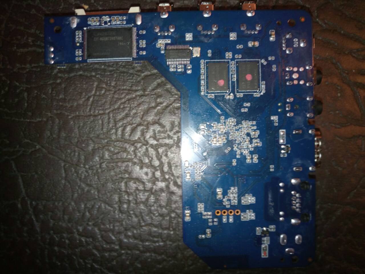

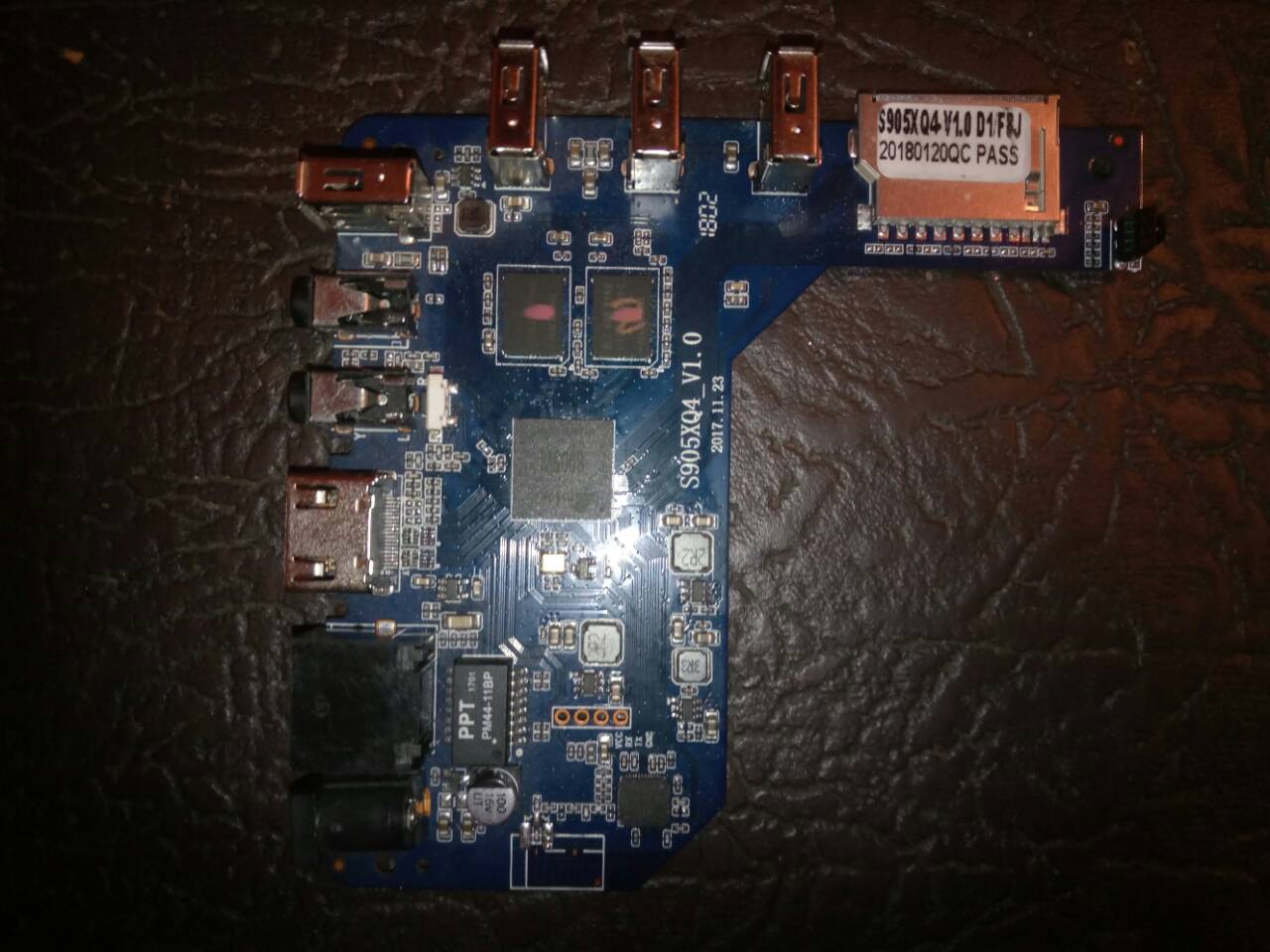

    I have this box:
    http://www.mario-sz.com/product/Priv...e-Q1-905W.html 8gb/1gb

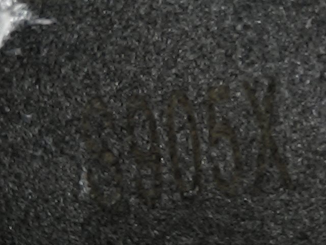

    The website shows that the unit it's running the S905w,but he actual chipset, under the heathsink, it's a S905X

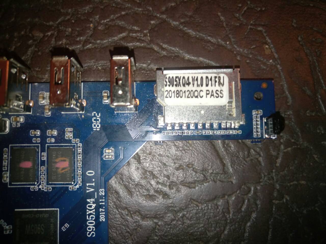

    The print on the PCB shows S905XQ4_V1.0 (Probably 4th quarter , since the date is 2017.11.23)
    The units prior to the incorrect upgrade was running Android 7.x.x and on a P281 board

  • Have you attempted to flash a ROM via USB Burning Tool with "erase flash" unchecked?
    Yes, erase flash unchecked.
    It will stop at 7% no matter what I do
    KernelPanic
    Before we move on, please remove the heatsink from the processor and check the exact type of CPU to avoid suspicion of installing a wrong bootloader.
    Yes, S905X on the PCB
