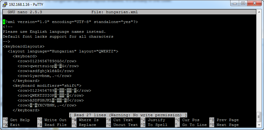

    I have found a keyboard layout at /usr/share/kodi/system/keyboardlayouts/hungarian.xml and some of charachters are represented with strange symbols. The xml file and Putty are in UTF-8.
    But maybe this isn't related to the main problem. I have found a topic with the same issue with no solution here.
