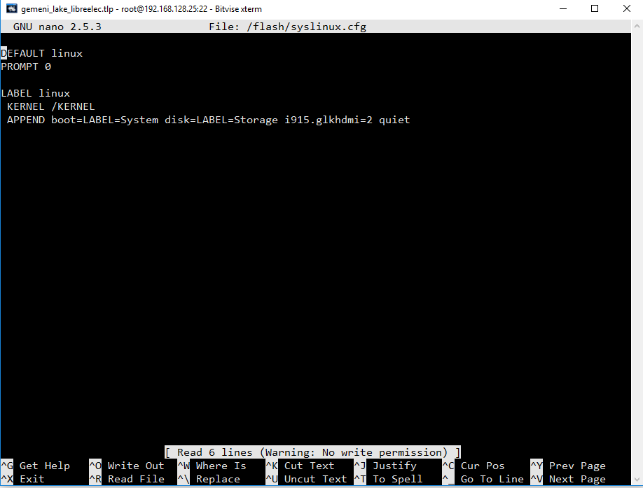

  • Addiing i915.glkhdmi=2 in /flash/syslinux.cfg works with my J5005-ITX on Bios 1.30, this Bios is availiable for the J5005-ITXand the J4105-ITX from Asrock.
    i try too edit the fill white winscp but is not allow (bios update is only if you use window ??) i run only libreelec
  • Ah, ok, no problem, you need putty to login as user root with password libreelec, on the installation start ssh must be set to on.
    When you on the system do this:
    mount -o remount,rw /flash
    nano /flash/syslinux.cfg
    Add the command and with crl+o you save it, ctrl+x leaves nano.
    type reboot and the system will reboot thats it..

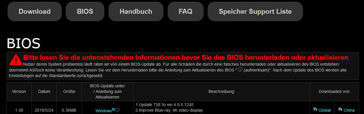

  • That is wrong, the BIOS Update is also for Linux, only the TXE Update is usable with Windows only.
    Install via USB Stick from the Bios itself was no problem with my board.
  • oke thanks i try it now
    part 2
    yes men it works
    did not know that it was so easy to update usb in bios and finished 5 minutes
    very, thank you for all your help finally work well
