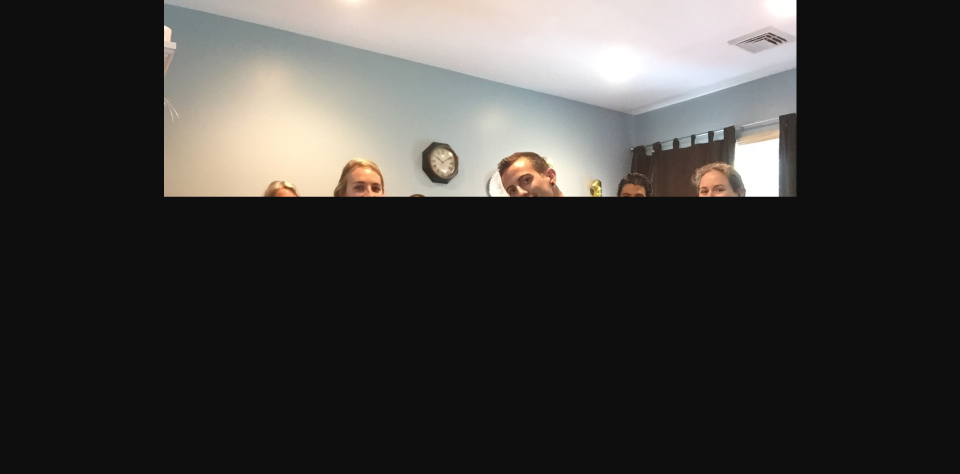

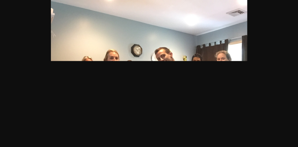

    There seems to be two images in use at the same time here. Both are attached.
    IMG_2340.JPG was loaded first and generated the NOTICE “unable to load” msg and then P1030033.JPG was loaded with no NOTICE “unable to load” msg. IMG_2340.JPG is attached. P1030033.JPG is 4.7M so it's too big for the bug report. It was taken with a conventional digital camera and not a smart phone.
  • Thanks for the reply CvH, Following up, I can confirm the photo is completely imaged on my system during slideshow playback, as show in the attached (which I downscaled to be smaller than 2M. I can also now report that the NOTICES and ERRORS only show up when Randomize is set on. During a sequential slideshow, there are no true errors. A few messages about "incorrect exif" but no significant errors. I think this is a bug in some section of the code since it seems to be related to the Randomize-On setting. Otherwise, both modes of slideshow should throw the same messages. A log file with sequential playback is also attached.

    WARNING: COMXImageFile::GetCodingType progressive images not supported by decoder
    best bet, update testwise to LE9 (milhouse build for example) and confirm if it works there or not
    MAKE BACKUP !!! downgrade to LE8.2 is likely not possible without damage
