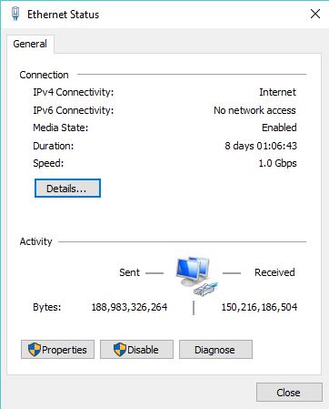

Will do. The Ethernet status on the server shows speed at 1.0Gbps, so that's a start.
