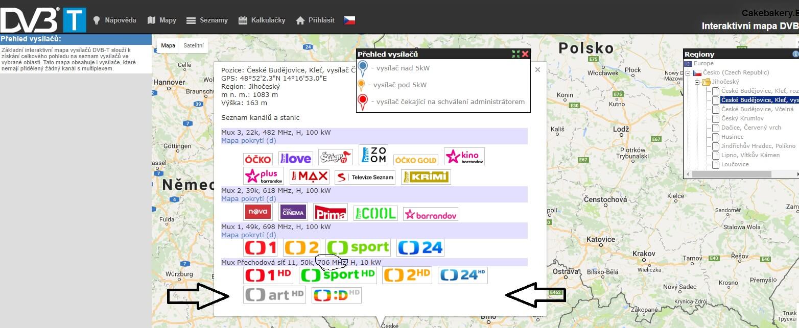

no, Czech Republic...706Mhz ...
TVH debug:
2018-04-09 21:17:51.508 subscription: 03DC: "scan" subscribing to mux "706MHz", weigh t : 6, adapter: "Panasonic MN88472 #0 : DVB-T #0", network: "pokus", service: "Raw PID Subscription"¨
2018-04-09 21:17:56.508 mpegts: 706MHz in pokus - scan no data, failed -
- Official Post
could you link me that size ? I am "next" to Liberec so I could test it if you can link me the frequencies
