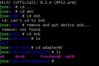

  • I have a Afatech AF9013 (device to view TV with tvheadend), and every time that I restart libreleec I have to remove and put the device so that it works.
    There are times I need to restart it but I'm not at home, how can I reproduce the command that is executed when I take out and put a device without physically having to do it?
    It is not problem of tvheadend since this happens even though this is disabled.

  • These is the solution, I put it in case someone has the same problem:
    To view modules use lsmod
    The module is dvb_usb_af9015
    And then write:
       modprobe -r dvb_usb_af9015 to disable
       modprobe dvb_usb_af9015 to enable again
    And device is working!!
