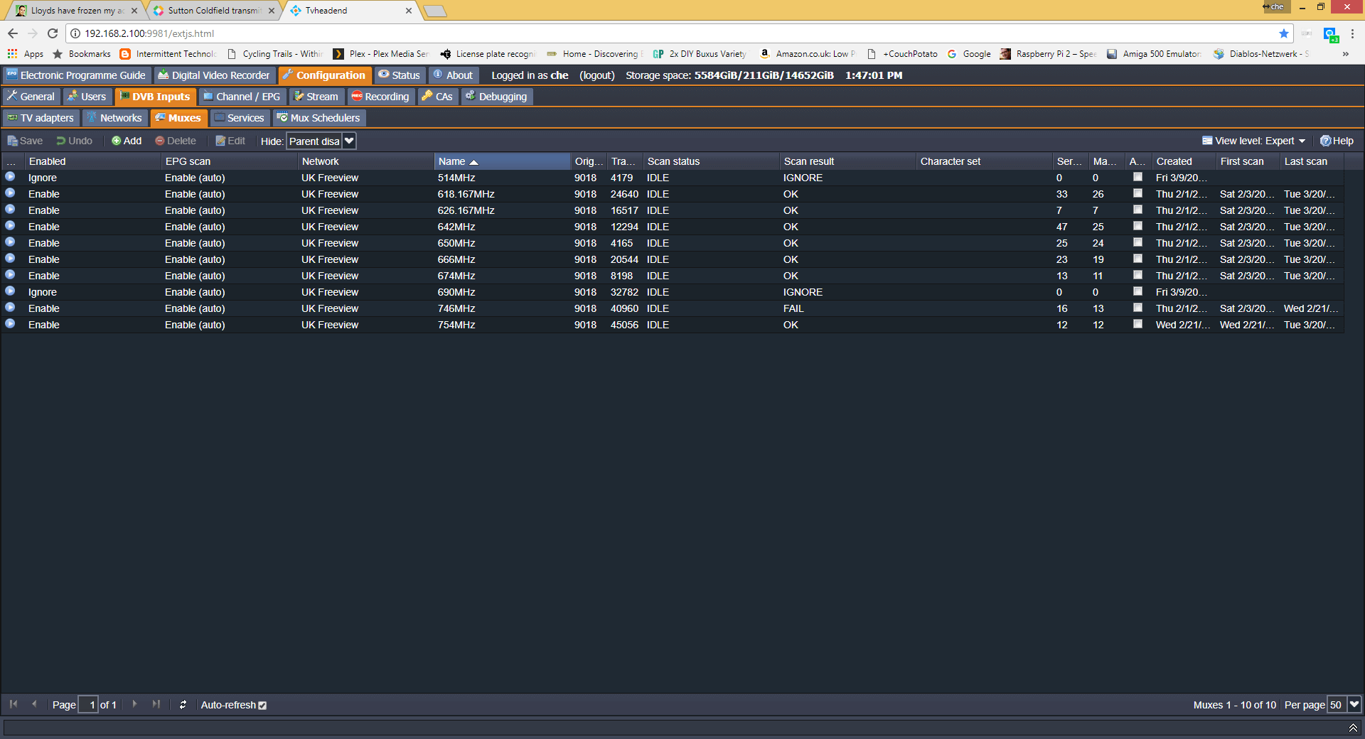

On a separate subject, I've had some bother with channels not working on the Sutton Coldfield transmitter. What was working before (I set up the MUXes by hand) have been taking ages to provide a video feed i.e. If I select Freesports, I'd have to wait at least 20 seconds before any live TV started.
I tried to retune tonight and I appear to have gone from about 190 services to 148. The following MUXs now fail to scan:
586MHz (COM8 - was working, now isn't. I had to add this one by hand.)
690MHz (No longer present - Service file out of date?)
514MHz (No longer present - Service file out of date?)
570MHz (COM7)
714MHz (no use anyway)
586MHz MUX is set as
Enabled
Enabled (Auto)
DVB-T2
586000000
8MHz
QAM/256
32k
1/128
None
2/3
None
-1
Can anyone shed some light on this, please?
