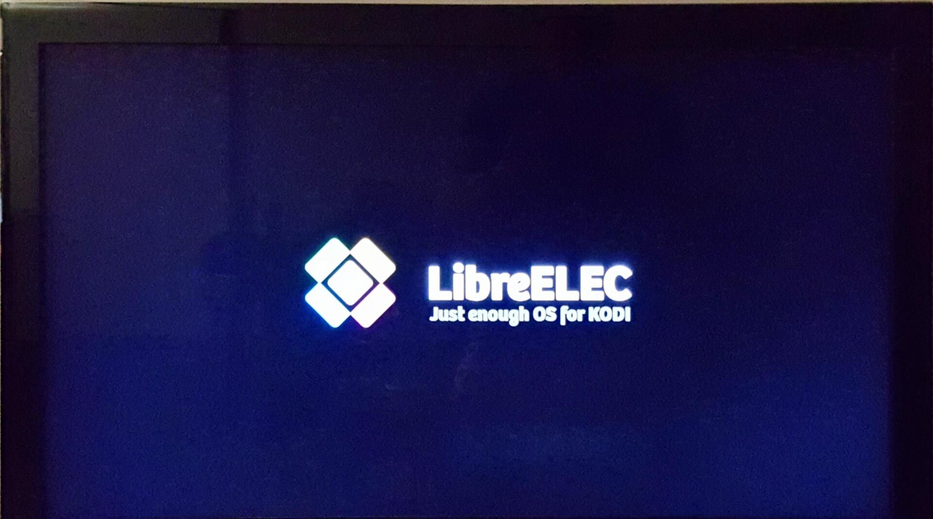

    Can any of you please help me in solving the HDMI output issue I have?
    When connecting my htpc to my tv via HDMI I only get a LibreELEC image and am not able to specify HDMI as output destination for video within Kodi (I can select it for audio which is working fine), there are just two options (default & LVDS2).

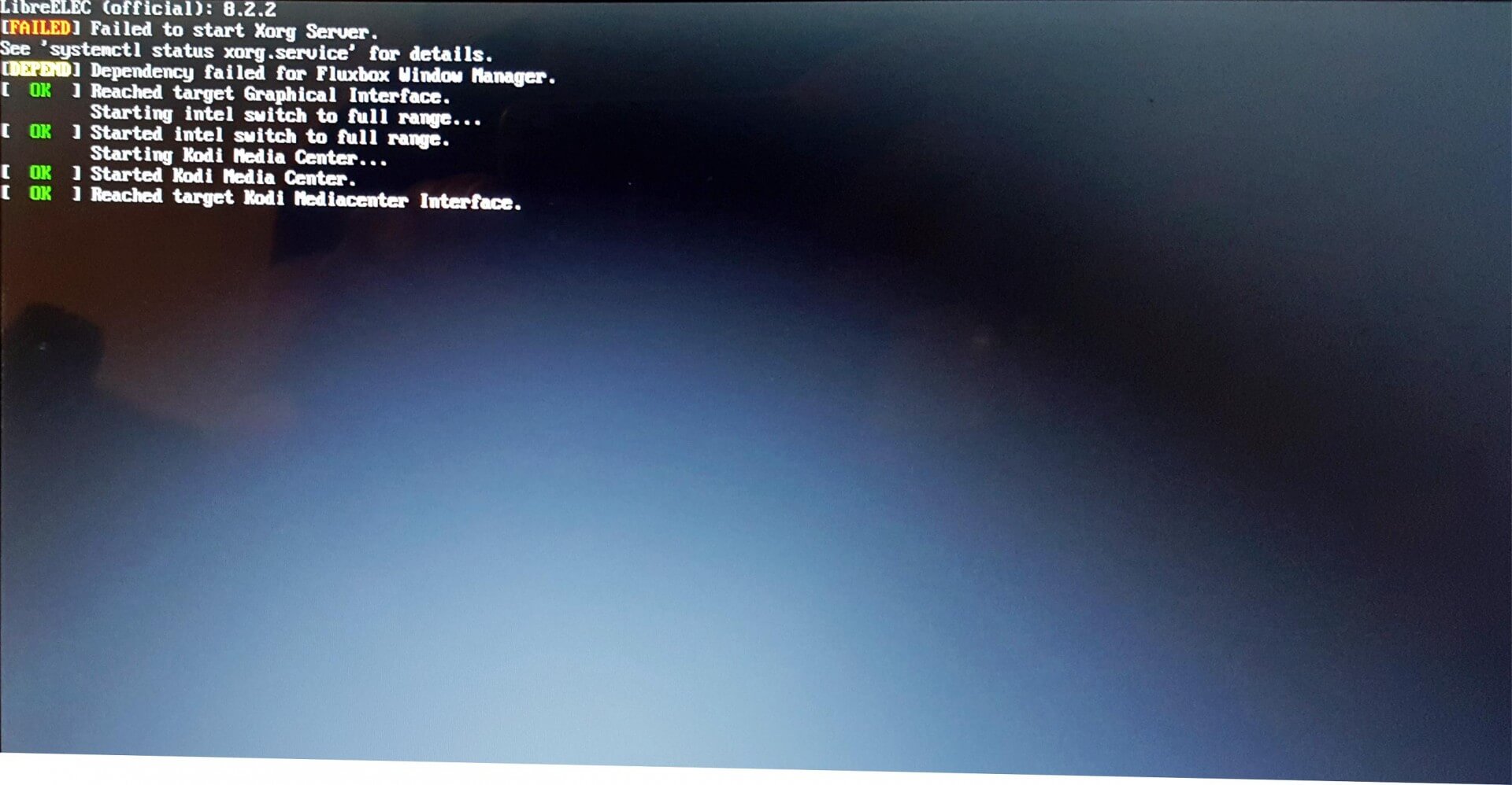

    After performing you described change I got A start job is running for Xorg Server
    After a short time I get:
    [FAILED] Failed to start Sorg Server.
    See 'systemctl status xorg.service' for details.
    [DEPEND] Dependency failed for Fluxbox Window Manager.
    [ OK ] Reached target Graphical INterface.
    Starting intel switch to full range...
    [ OK ] Started intel switch to full range.
    Starting Kodi Media Center...
    [ OK ] Started Kodi Media Center.
    [ OK ] Reached target Kodie Mediacenter Interface.
    That's it, no Kodi on the laptop screen and only a LibreELEC image on the TV.
    After adding the removed line (see below) back to the file, but now as last entry the result stayed the same.
    Once I restored the line to it's original location I was able to start Kodi and see the interface. Unfortunately without any option to select HDMI as video output.
    I have attached the content of command 'systemctl status xorg.service' and file '97-xorg.rules'.
    Also I added two foto's showing the result (notebook screen and TV)
    The foto of the TV isn't showing the 4 colors of the image as I can see them, believe me the colors are there ;)

  • The "failed to start Xorg" message indicates there are no Xorg graphics drivers that support that card in the OS image. It dates from 2009/10 which is probably just beyond the current drivers we use; AMD support for older cards isn't so great. The LE boot splash that you see is just the boot splash.

    I mentioned the splash screen to indicate the video adapter is recognized. Apparently not fully.
