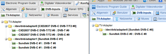

    After copying over the configuration, I re-enabled TvHeadend server, headed over to the Web-If and attached the DVB-adapter to the DVB-C network and enabled it. Here, it can already be seen, that something is not quite right, because TvHeadend only sees the DVB-C part of the tuner, not the DVB-T part (on the left you can see the situation on the Wetek Play (as it should be) and to the left the situation on an AML S905X):

  • Here, it can already be seen, that something is not quite right, because TvHeadend only sees the DVB-C part of the tuner, not the DVB-T part (on the left you can see the situation on the Wetek Play (as it should be) and to the left the situation on an AML S905X):
    I think stick can only work in one mode and not both. Or this is dual tuner? In addon settings you can enable DVB-C o DVB-T and this mode is set when driver is started. If this is dual tuner then I should change this in settings. But I doubt. At least Marcus newer requested this.
  • I think stick can only work in one mode and not both. Or this is dual tuner? In addon settings you can enable DVB-C o DVB-T and this mode is set when driver is started. If this is dual tuner then I should change this in settings. But I doubt. At least Marcus newer requested this.
    Actually, I tried this also, explicitly setting DVB-C mode in the config, but that did not change anything. As the picture shows, what we see on the china boxes is not normal. Both capabilities should be visible.
