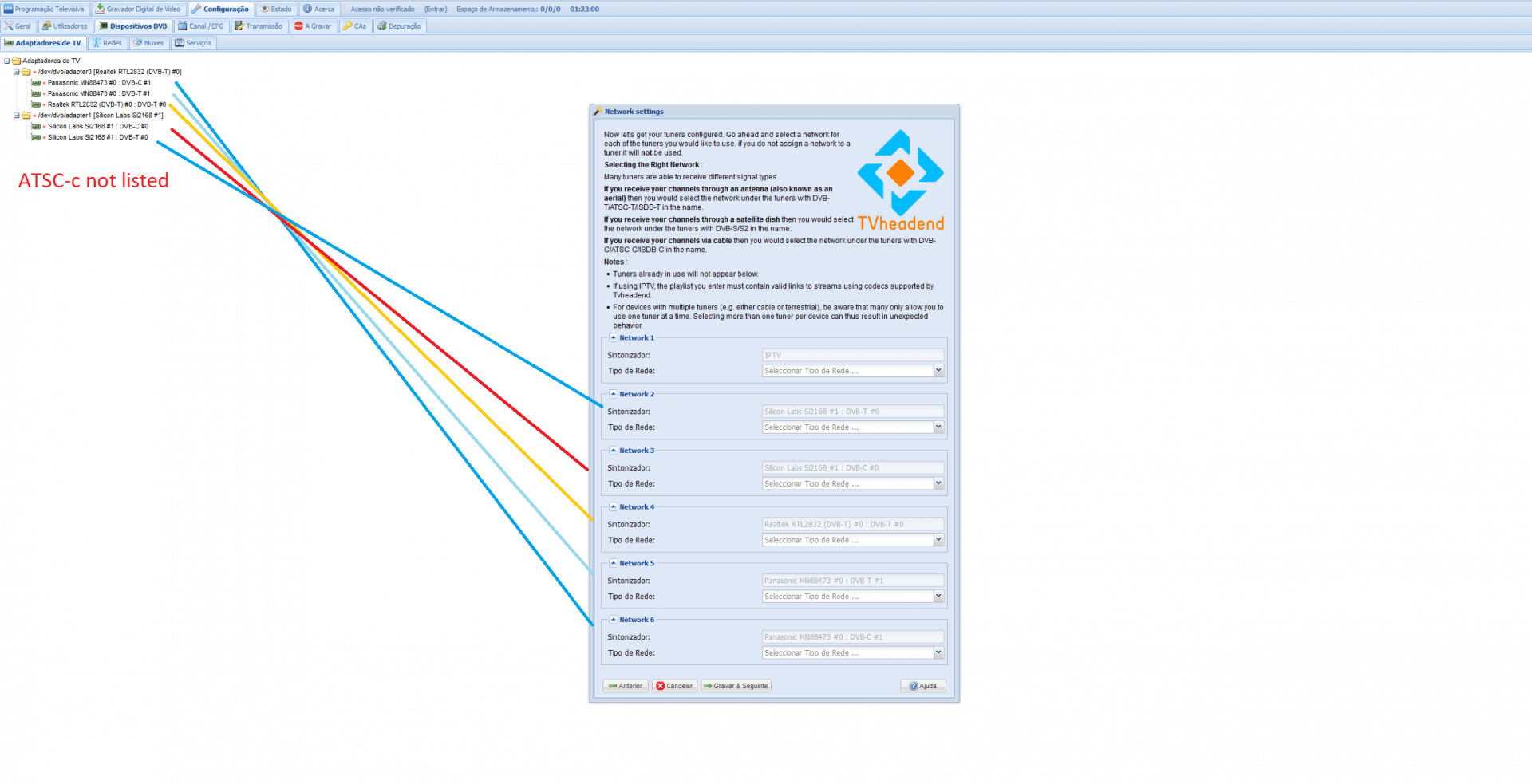

then it might be some Tvh setting at scan, could you make some pics of the Tvh -> configuration -> dvb inputs -> networks -> your network

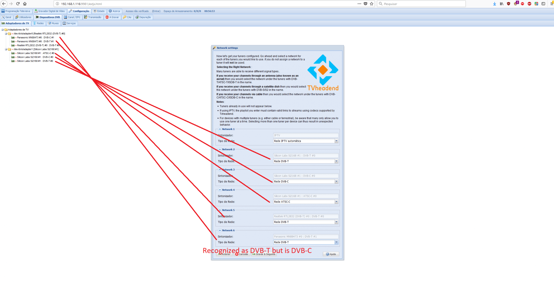

Take a look in photo. I tested it with LibreELEC-Generic.x86_64-8.2.0-dvb-1.1.img and the order changed it it are reconized right. i reinstall LibreELEC-Generic.x86_64-8.2.0-dvb-1.1.img to take a photo too... DVB-C of MN88473 is listed ok and search for channels good... in official release not works. Thanks for this version CvH !!! i'm testing it now...
