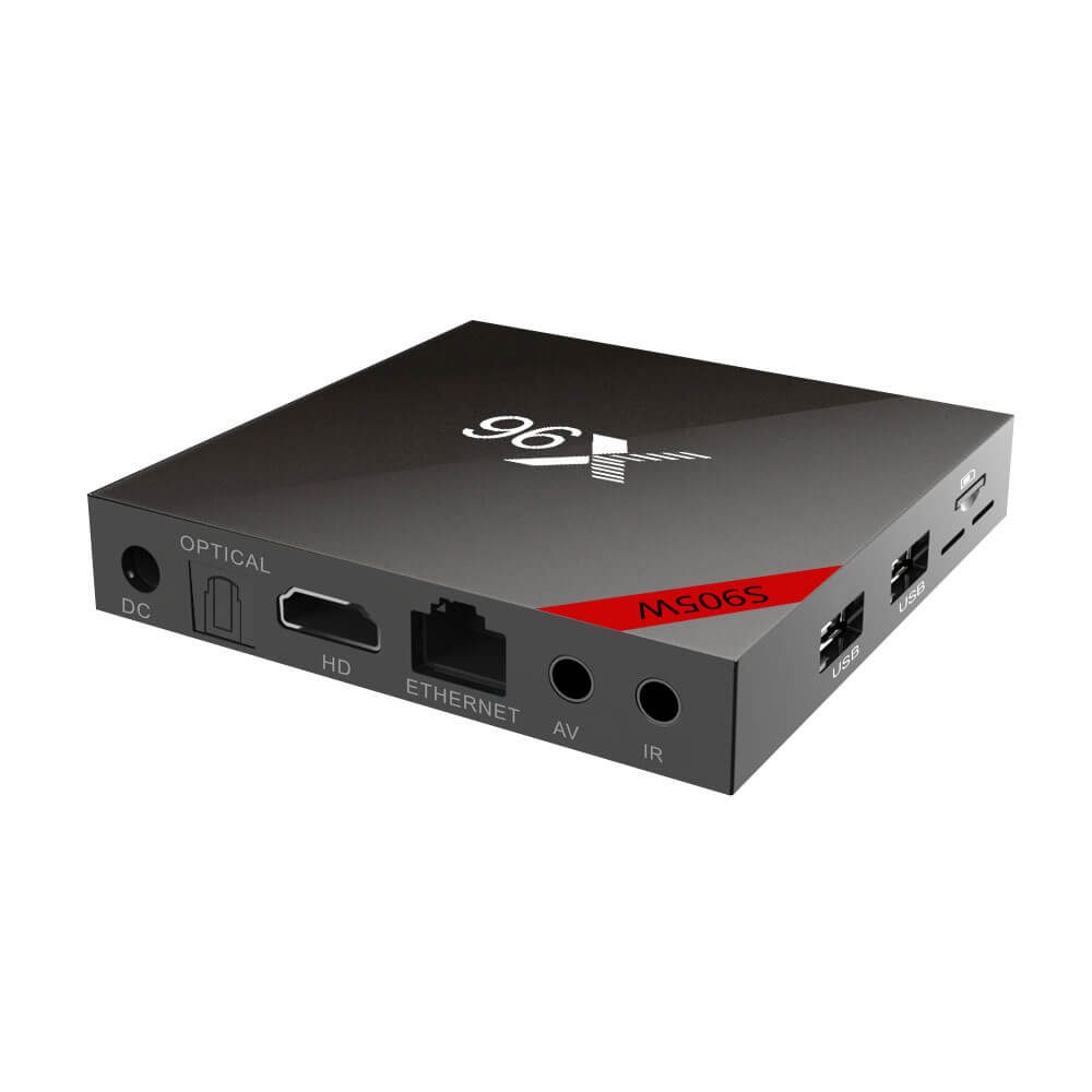

X96 S905W

The S905/S905x version should work? My device wont boot from sd already tried that. What devicetree should i die then?

maybe i can help...if u have same box ( looks like to me...it s a s905 w chip)
flashed with android app " reboot to libreelec " on usb stick ( sd card usb adapter ) with follow. imagges : LibreELEC-S905.arm-8.2-8.1.9.img.gz und device tree gxl_p212_2g.dtbs

Thanks for this appendizitis. This box looks really cute have to order one, just to have it. Is there a built in IR Receiver or do i need an external Receiver with jack cable?
hi...the ir-receiver is in the box with cable !!

Got it working now. But when de device reboots the screen goes black and it doesn’t boot. I installed it the to sd card
Is your box a 1GB or 2GB? Sounds like you used the wrong device tree.
1gb but i used that device tree. I succesfully installed libreelec. But after that it wont boot anymore
hi...the device tree for mine was 2gb/16gb...maybe thats the problem..try another
So it is possible to boot a device with a wrong device tree? Thats weird. Gonna try that thanks
was the first reboot?...just my 2 cent, sy
First boot installed LE. First reboot after the install it doesnt boot
