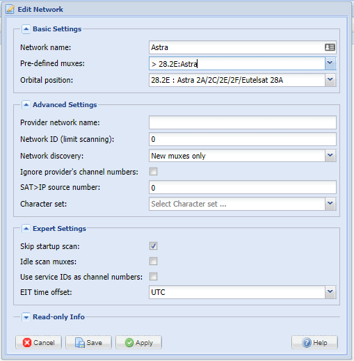

    need some help getting TVHeadend working. I've got a DVBSKY S960 tuner. If I do a fresh LE install, followed by a TVHeadend 4.2 install and run the wizard, it finds services okay. If I map to channels, that's okay, although the numbers are messed up. Nothing I do regarding bouquets makes a difference - all the channels have bouquet set to auto - trying to change it by unticking auto doesn't give anything in the drop down box. I can watch channels at this point though.

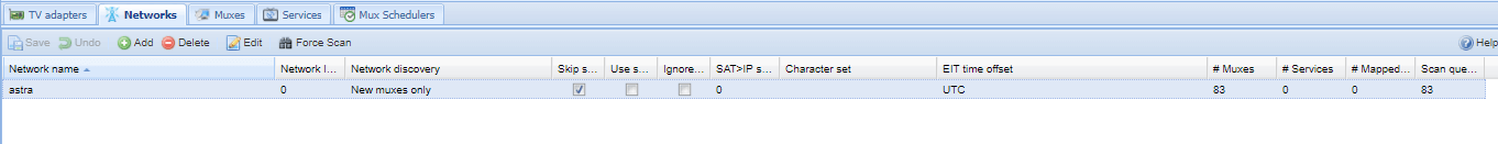

    Trying to start over by deleting the channels, muxes, network - it never scans the muxes successfully again - scan no data errors.

    Sample output from manual add of network \ muxes below. Have tried changing timout, force old etc

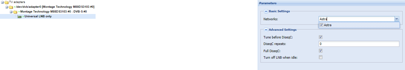

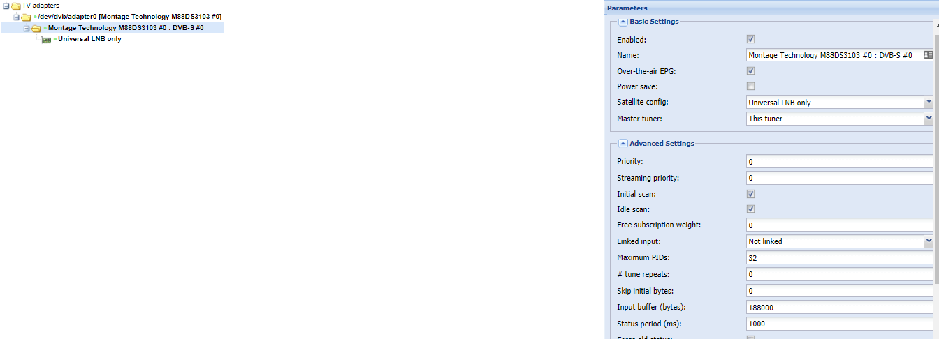

  • Yes. Done several scans trying the different settings on the adaptor (Input Buffer, Force old status, remove scrambled bits) to no avail.
    Watched the stream and getting good signal strength whilst it's trying.
