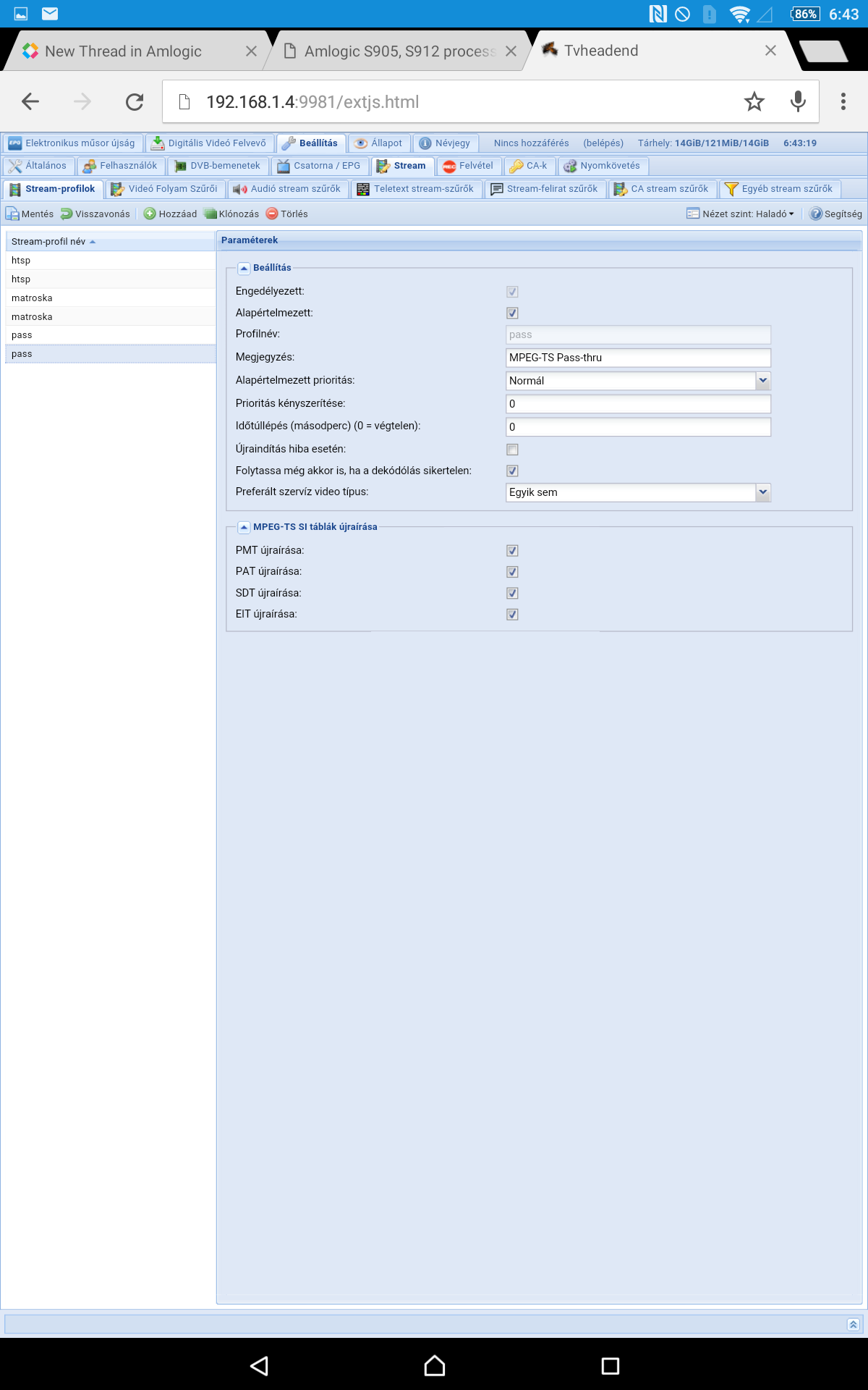

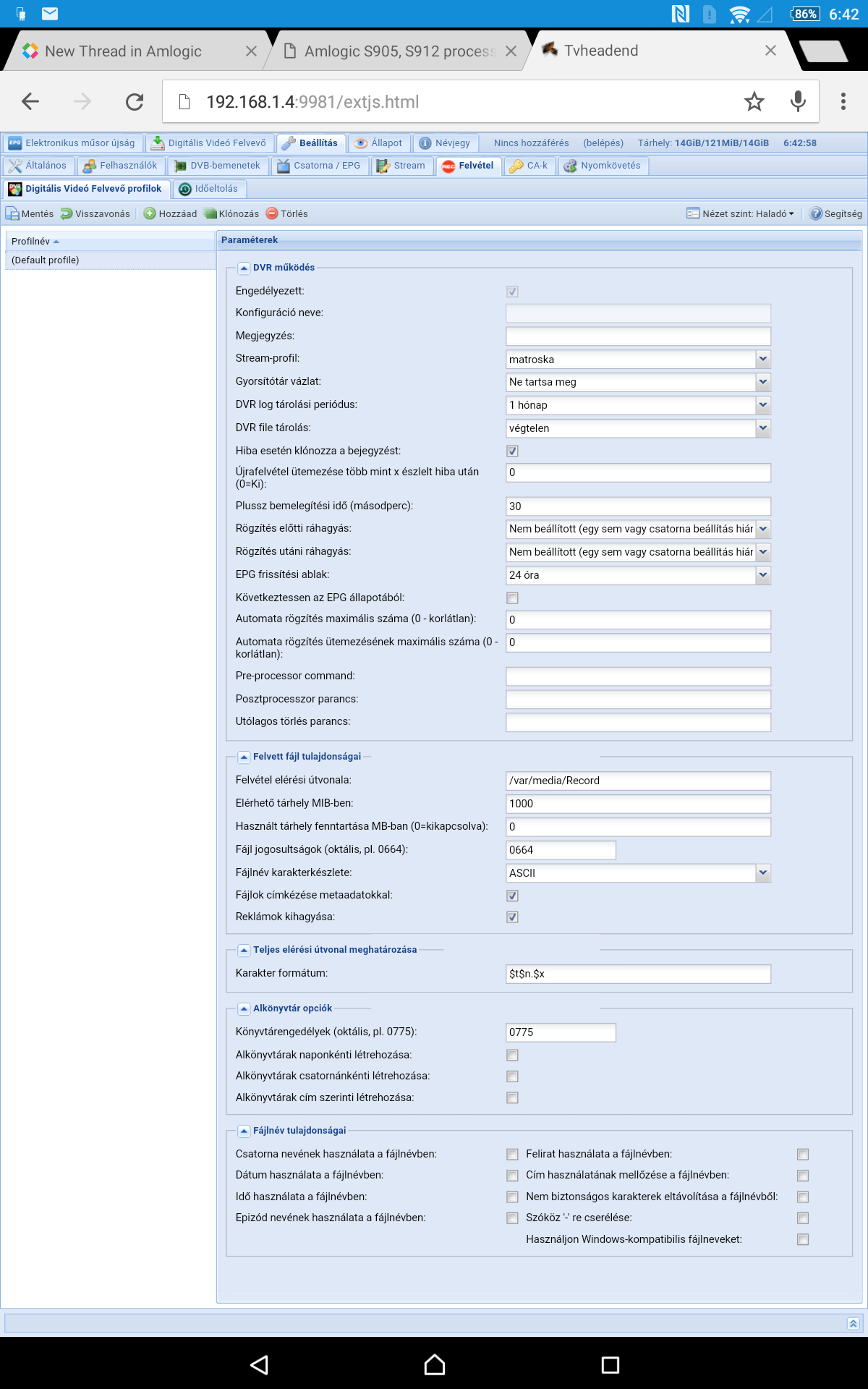

the difference from live TV and recorded video is the format.
Live TV streaming profile htsp, and isn't changeable
Record profile is mkv.
With htsp profile isn't record the server, and with ts pass profile same result as mkv.
