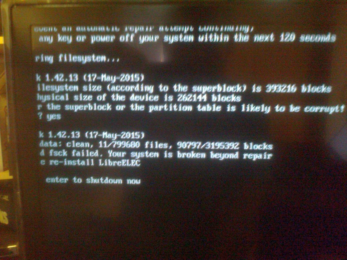

So I decieded to install to nand, since KODI worked a bit slow sometimes.
I install through SSH, and it finished to install.
but something is wrong.
this is the screen after some autorepair starts, when booting.
I dont what to do now ? I have tried rebooting the original X96 firmware. no luck.
what can I do ??

It states everytime I try to boot something or wipe data or anything actually.
E:Cannot load volume /misc!
I have tried opening amlogic-usb-burning-tool-v2-0-8 but it cant load the firmware..
im stuck here..
SOLVED: reinstalled twice, and it worked.
the remote is not working, so im about to do a full reinstall of the android image, and start from scratch again untill I get a flawless install.
