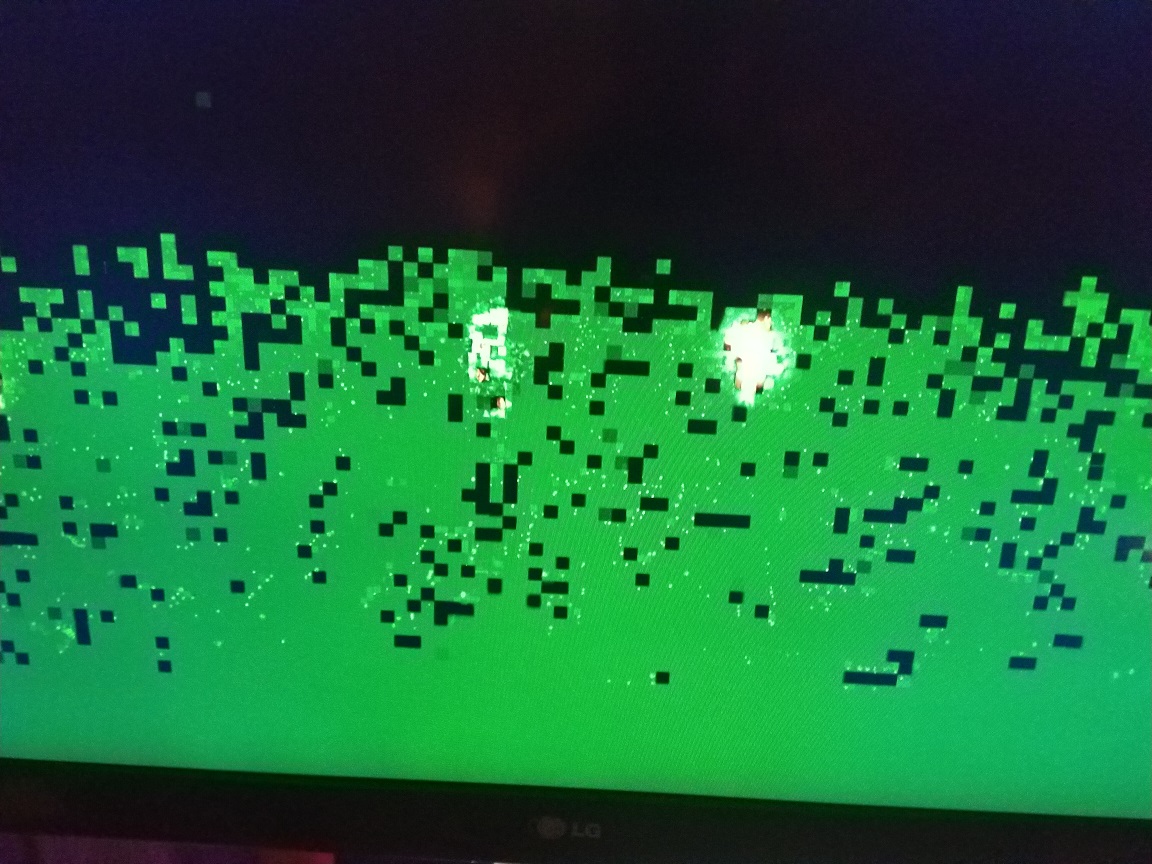

    Strange I just tried playing another Blu-ray ISO rip "Avatar" and that one seems to be playing OK with VC-1 VAAPI turned on and hardware acceleration.
    I then played Close Encounters of the Third Kind and that plays OK as well, as does I,Robot and Independence Day
    So the green screen / artifacts issue seems to not affect all Blu-ray ISO rips for some reason.
    Dark City, Children of Men and Inception are the same as Blade Runner however with green screen / artifacts
    In the Kodi Player -> Videos settings if I completely turn off VAAPI Hardware Acceleration for all types and play the Blade Runner Blu-ray ISO rip again, it now plays OK and the green screen and artifacts have gone.
    So what's changed between the two versions of LibreELEC / Kodi to break hardware acceleration of Blu-ray ISOs ?
    I then went back in to Player -> Videos settings and turned back on VAAPI Hardware Acceleration. I then just turned off VC-1 VAAPI only and played the movie again. And it is playing OK. Pressing guide on the remote brings up some information.

    Hello
    I just updated my HTPC to LibreElec 9.0.0 / Kodi V18 Leia and now when I play Blu-ray ISO rips I get green screening and artifacts.
    Motherboard - Intel DH67CF
    CPU – Intel 2nd Generation Core i3-2100
    i never had this problem on LibreElec 8.2.5 / Kodi V17.6 Krypton.
    The HTPC is connected to a Denon AVR-1513.
    I have VAAPI Hardware Acceleration turned on for all types and Audio passthrough turned on for all types etc.
    Attached screen shot is the start of Blade Runner with the cityscape and flaming towers.
    Also DVD Video_TS rips stopped playing properly in LibreElec 9.0.0, I had a lot of motion judder / slowness, lip sync way way out, video skipping of its own accord etc.
    I changed the following video playback setting and now the DVD VIDEO_TS rips seem to be playing better.
    Video Scaling Method - I changed from Lanczos3 - Optimised to be Bilinear.
    The Deinterlace method is set to VAAPI - Bob.
    Thanks
