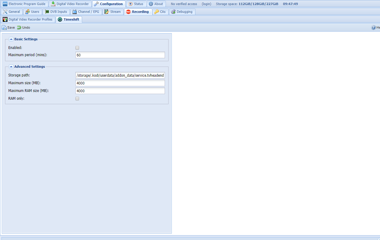

Timeshift works fllawless in conjunction with Tvheadend for me. But for me it already did work using LE 8.

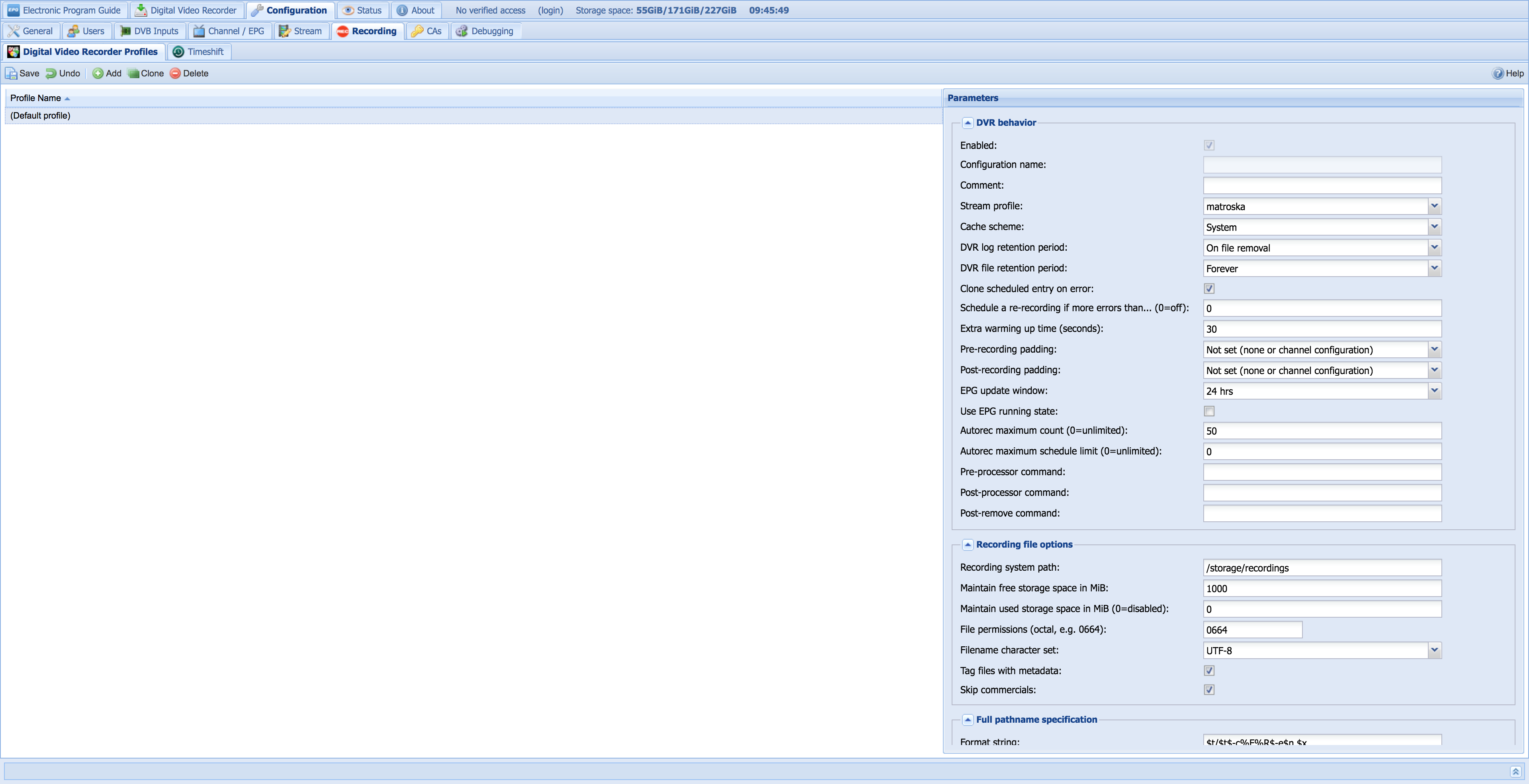

I can't play DVB-T2 (Tvheadend) recordings with Dolby audio since LE 9.0 (Generic). I can play the recordings fine using any other player on any other platform. It's a bug that got introduced with LE 9.0/Kodi 18. Watching live TV with Dolby audio works fine though. It's just the recordings that do not work anymore. Using fresh install of LE 9.0.2 Generic on ASRock J4205
Exemplary recording from German public TV that cannot be played back anymore using current LE/Kodi: https://drive.google.com/open?id=1h1f2qcktkkvqabg6tiz1oad7shw57cos
Under "Stream profile" on the right you simply select "matroska"
