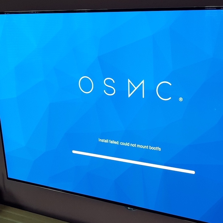

kszaq: Maybe the content of the OSMC Image can help you to improve your builds
or it is possible to flash the s905X boxes to OSMC to check out the differences?! -
Last week "OSMC" launched the "Vero 4k" player, with their own Kodi OS Version.
The Vero 4k have 2Gb Ram & 16GB Rom with 100 Mbit Ethernet and Wlan ac.
The chipset is a S905X and the Ports + Design is the same like a X96 Android TV.I downloaded the image from OSMC and will try to boot it from microSD.
Anyone have some infos about the "Vero 4K" and it possible, we can get LibreElec or OSMC run on our Android Box
UPDATE: DTB.IMG is nearly 1:1 between Vero 4k image and our device tree from LibreElec.... unfortunately im already lying in the bed, to try it out.
UPDATE2: I write the OSMC image on a USB Stick and booted it up in my x96. The OSMC Installer started and give me this Error (cant mount bootfs):
