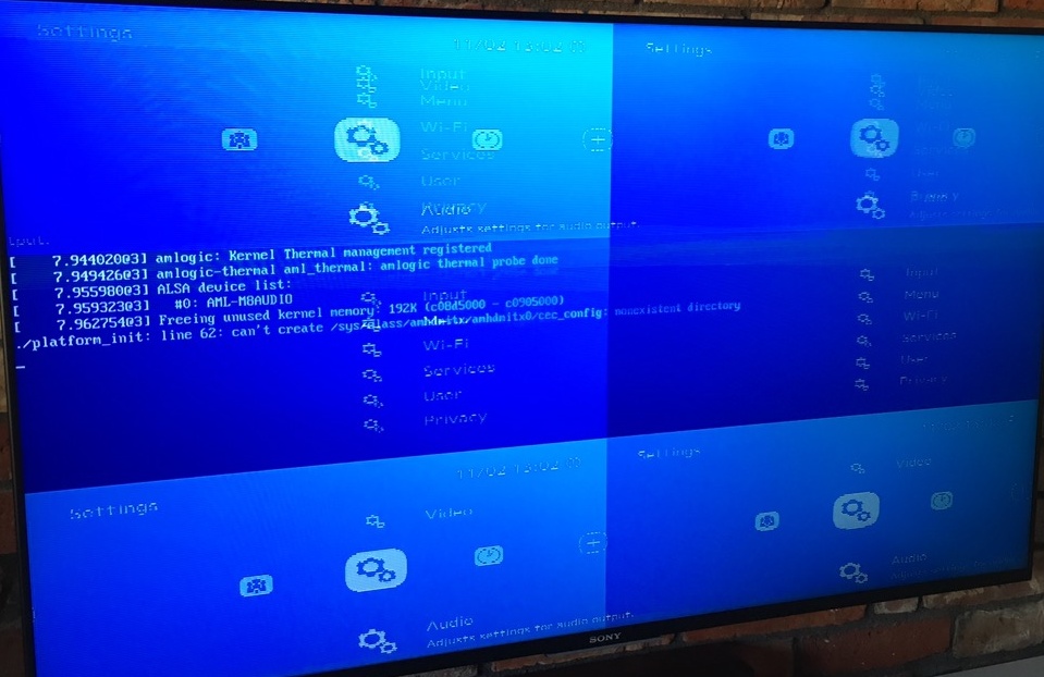

    Demetris. Looks like it nothing corresponding resolution. I tried this commands to check different resolution and it changes but display are still broken (#121)
    # echo 1080p50hz > /sys/class/display/mode
    # echo 1080p60hz > /sys/class/display/mode
    # echo 720p50hz > /sys/class/display/mode
    # echo 720p60hz > /sys/class/display/mode
    # echo 1080i50hz > /sys/class/display/mode
    # echo 1080i60hz > /sys/class/display/mode
    # echo 720i50hz > /sys/class/display/mode
    # echo 720i60hz > /sys/class/display/mode
    I just looking for working configuration. It's no matter to me which resolution I will be using.
    In android I have set [email protected]
    Demetris I think that we misunderstood each other. I don't want to change resolution. When I installed your Lakke image and get this slided image (#121) I just thought about changing resolution like a solution for my problem and only asked you about it.
    I've just done a fresh install and tried your latest image (compiled 16:54) but still no luck :(
