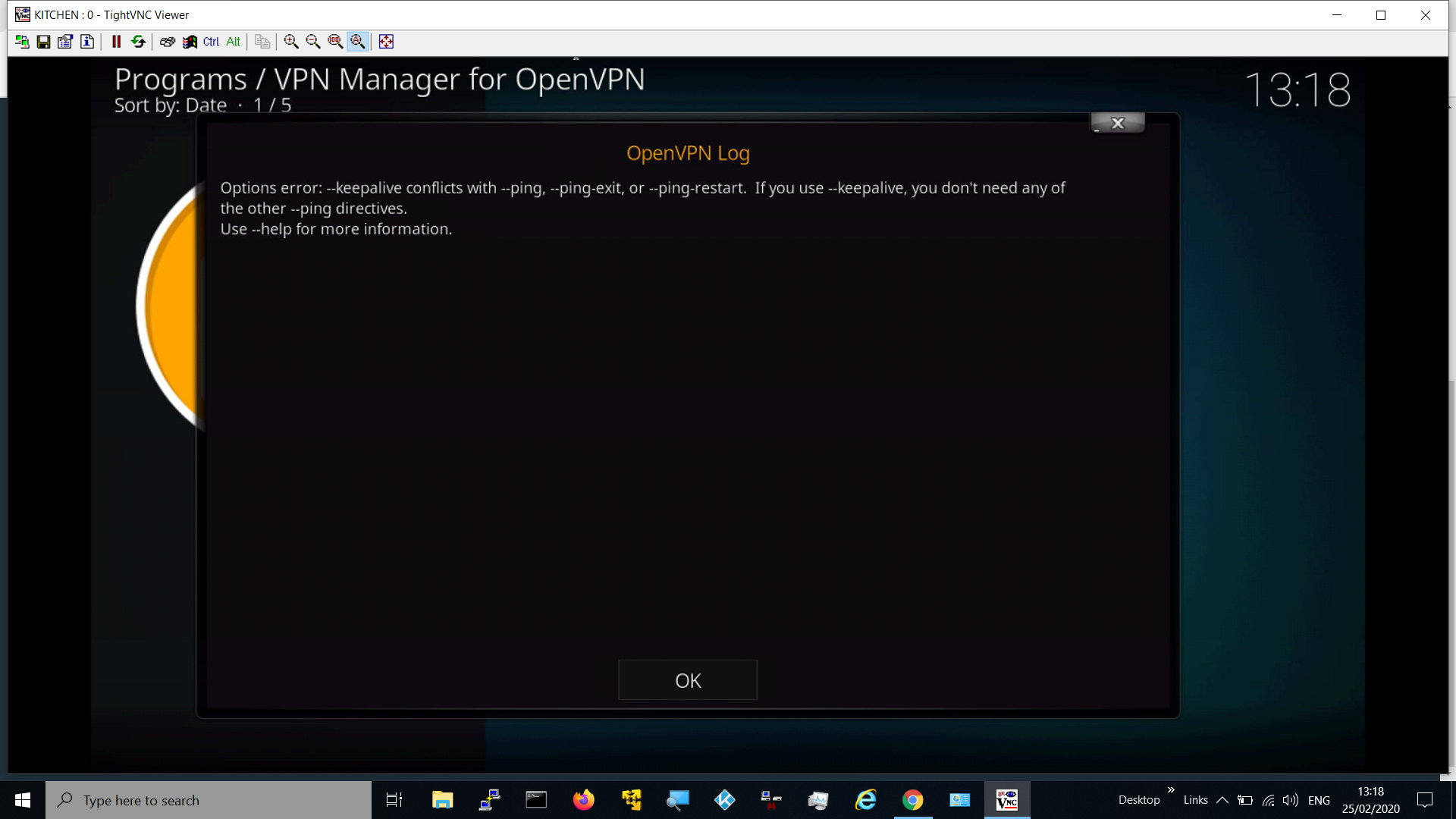

    Hello,
    Great addon, I've used it for years with very little issues. Recently, I had a problem with my own router firmware software update which broke my own vpn for a few months. That is sorted now, my phone and laptop work with the vpn again but unfortunately vpn manager won't.
    I've always used the import wizard for my user defined vpn with minimum fuss but now it wont connect and is reporting errors. Any advice please?
    Please see screen shot.
    Thank you.
    Update.
    I deleted the keep alive 60 15 line from the client.opvn file and it now works.
    Hopefully this won't cause issues?
