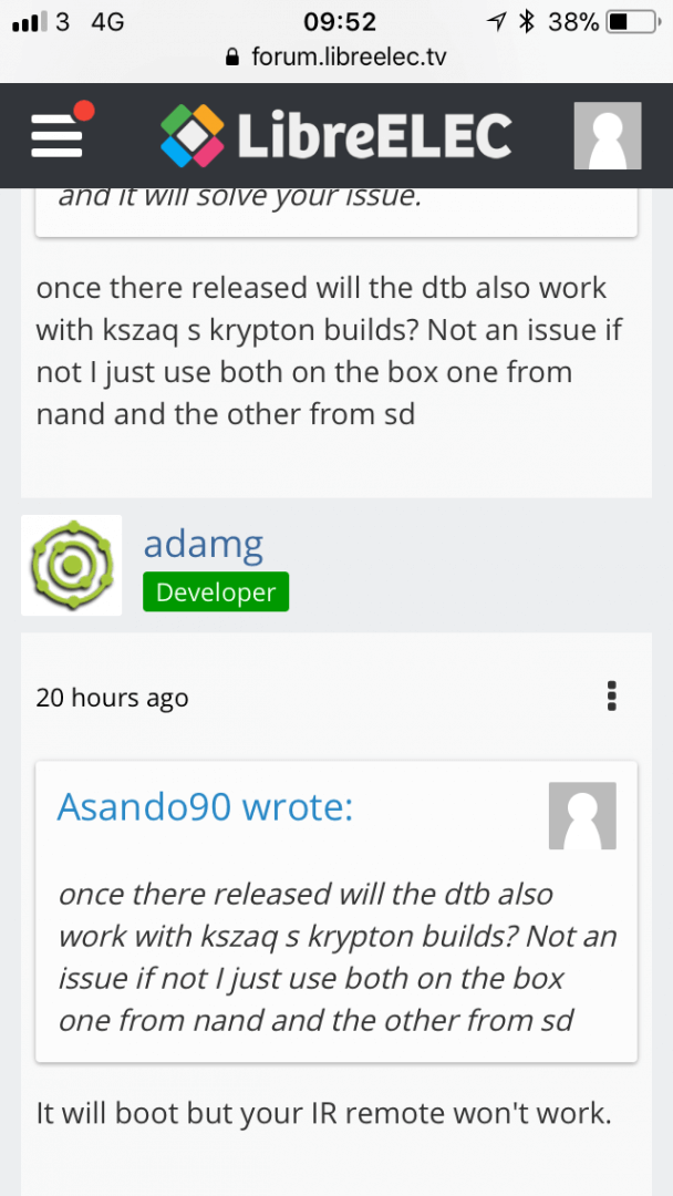

Will I be able to copy my remote config file over from my current 8.2.3.1 build to the new 8.90.4 build once available to keep the or remote working on both builds?
It will boot but your IR remote won't work.
so I’ll need to set up a remote config or buy a 2.4ghz Bluetooth remote to run both ( on the 2.4 ghz remote do these need config files setting up or are they p and p
Please wait for 8.90.4
When burning .img.gz to an SDCard there will be a subfolder called device_trees, inside you will find gxl_p281_2g_tx3mini.dtb rename this to dtb.img and place in the ROOT directory and it will solve your issue.once there released will the dtb also work with kszaq s krypton builds? Not an issue if not I just use both on the box one from nand and the other from sd
