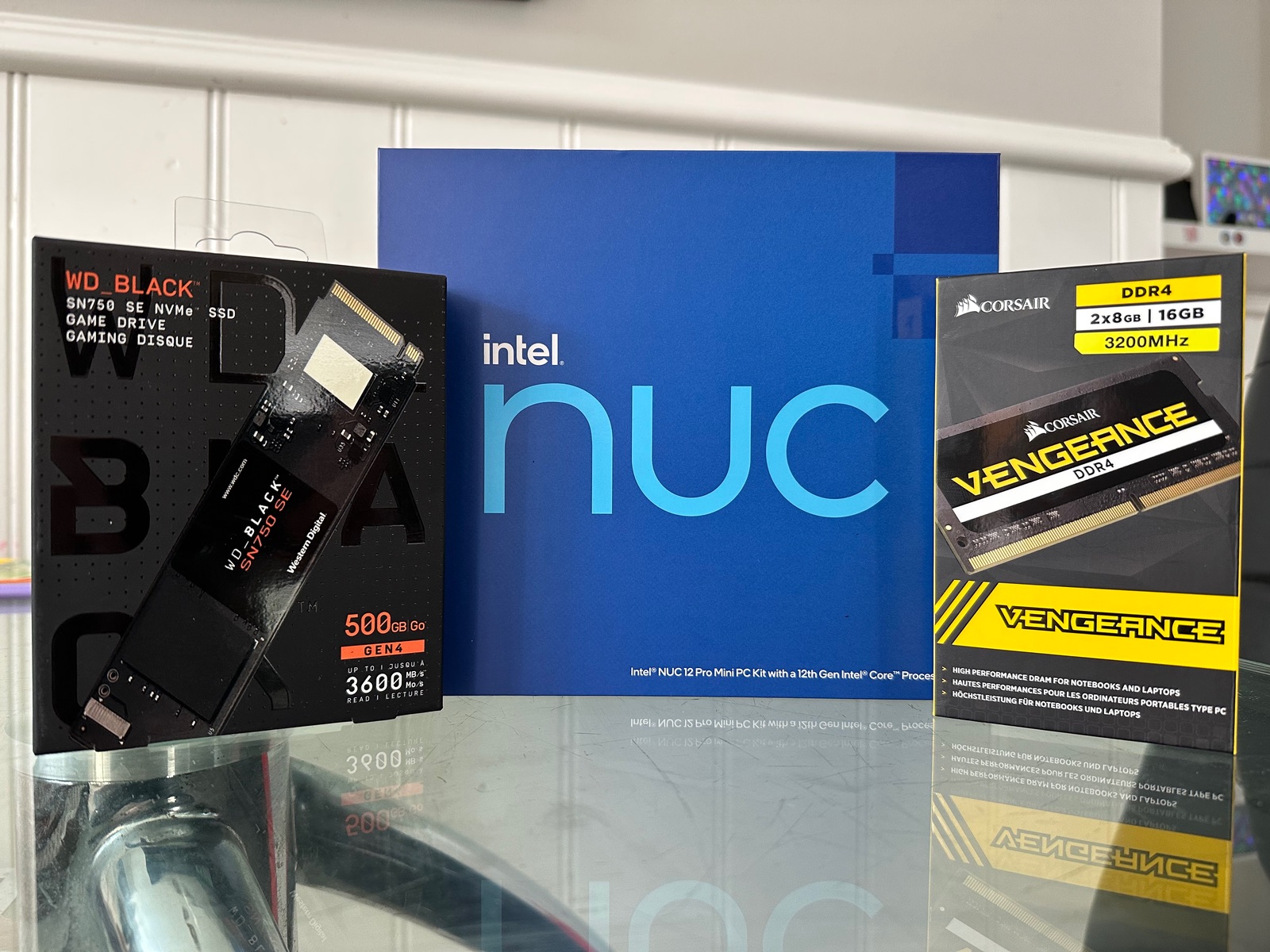

I haven’t used a RPI4. However I have a JVC projector and a lumagen. The intel Nuc 12 works fine with HDR. However will not correctly output HDR10+ files. Also will not output 4k60 HDR content at the moment either.
I’m currently building a Ryzen system to compare.

Hi,
I have a new Intel Nuc 12, plugged into a lumagen pro then into my JVC X5900. On the current nightlies HDR works fine for most titles. However some, Star Trek Into Darkness as an example will only output in SDR709. Other movies work fine.
It’s like it doesn’t know what to do with the file, I’m thinking maybe it’s HDR10+? Anyway I’ve posted my log here.
