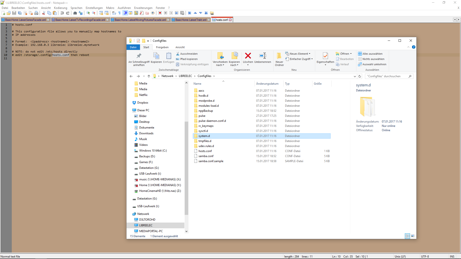

1) Add <server name> <ip address> to ./storage/hosts.conf and reboot
or
Access it directly in Kodi as smb://<server IP>/<folder>I have tried both with the latest beta 7.95.1 but the same. Only the 2 external hdds make problems.
EDIT::
For testing, i installed win 10 + kodi on a drive, start the NUC Client and try to access the usb storage drive, it works perfect. Switch back to Libre, and the issue is back.
Here actaul log file FIlme 5 / Serien 5 / Filme 4 this are the issue maker.
I have add the server name and ip adresse at configfiles/hostconfig
