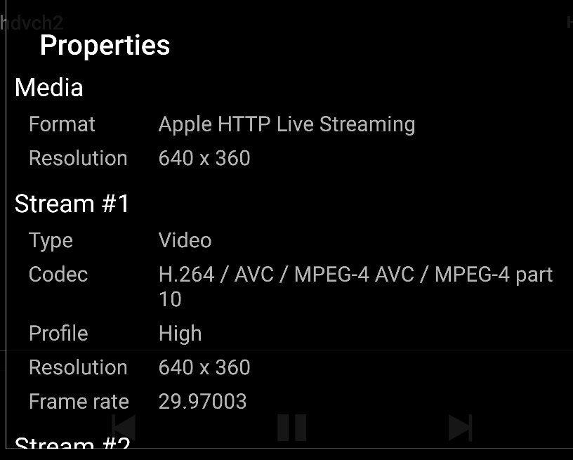

The screenshot is not helpful. Get us a full debug log, please
Sorry, new to this i thought the codec might be relevant to people.
Another thing i noticed was if I turn off hardware acceleration so only HD and lower played with hardware acceleration off then it did work. However I do not want to be toggling hardware on off for videos that can or cannot support it and would really would want to use the hardware acceleration as less load on the system and i feel as if the quality is better since i see less deinterlacing lines if that makes sense.
