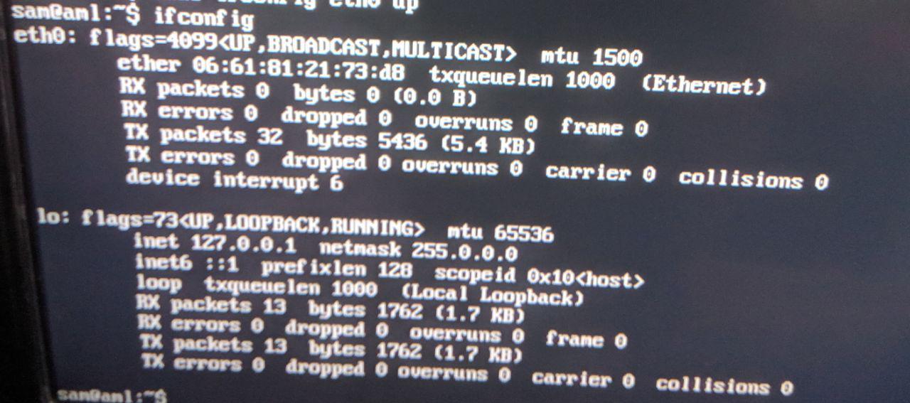

    What model of TV box ? What is DTB ? I checked on VIM1 VIM2 to make a copy and the installation work correctly. I found a problem with recovery (the process does not complete).
    Have you tried the nightly build of LE ?
    Yes, the build with the night of yesterday:

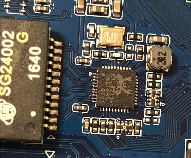

    Index of /
    None, take the network
    Edit: Can it be by the ethernet modulator?Its modulator is an SG24002G
    Edit2: insert the photo of the ethernet chip (realtek rRTL8211F) and its modulator (SG24002)
    Try all DTB options g12*.
    I've tried all of them, and none of them work with ethernet. Including the odroid n2 that uses the same ethernet chipset.
    P.D: The tests are done with the build LibreELEC-AMLG12.arm-9.80-devel-20190709172241-893dd58-s905x2.img.gz with the different dtb in the device_tree directory(both g12a * and g12b *), modifying the unev.ini file. . What more data can you use to facilitate the work?

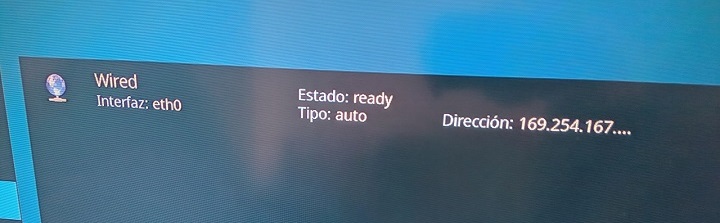

    Tested build LibreELEC-AMLG12.arm-9.80-devel-20190708135005-f20db18-s905x2.img.gz on tanix tx5 max. DTB: meson-g12a-x96-max.dtb
    Wifi and Bluetooth: RTL8822 (FN-LINK 6222B-SRB)
    Ethernet: RTL8211F (I think the same as the Odroid N2)
    Config Remote: attached file.
    Results:
    - Boots
    - Working remote with your configuration
    - Audio HDMI working
    - Ethernet not working, it does not get ip from the dhpc and even if you put the ip manually it does not work. (When the dhcp is on ethernet, take an ip 169.254.167.*. As seen in the photo I attached)
    - HEVC crahes (known issue)
    - No WiFi and bluetooth
    In case it helps, this is what the dmesg throws at me( (referring to the ethernet)):
